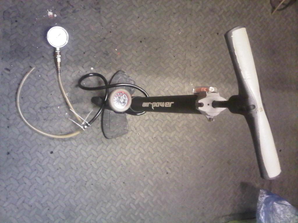

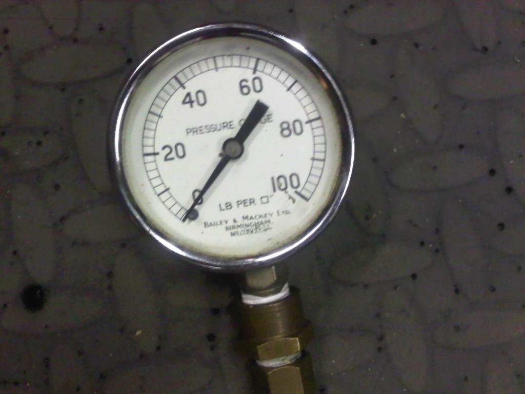

I used a bicycle pump with a separate pressure gauge connected to a Tee connector. Could have used the gauge on the pump but accuracy was suspect. A bicycle pump also has a one way valve built in so it will hold the pressure to perform a needle/seat leak test. Don't know the cost of a pop off test kit but if you already have a pump with a decent gauge to hand then it will do the same job and save you purchasing something you may not use very often.
