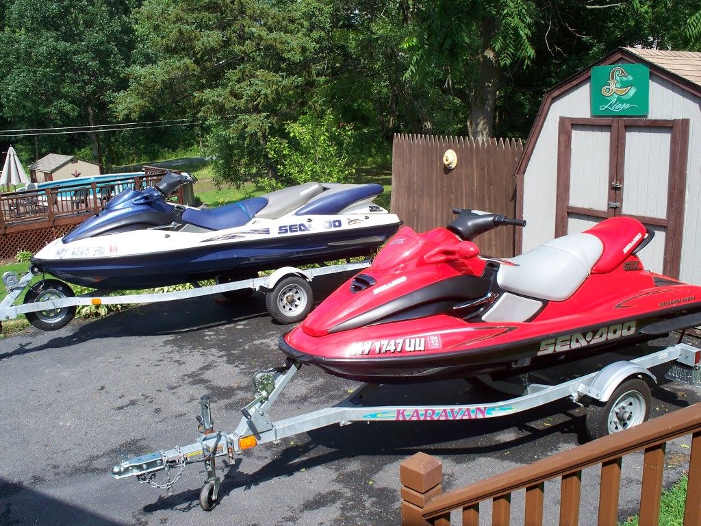

If you use the last option in photobucket. (with the IMG tag) it will show up like this...
