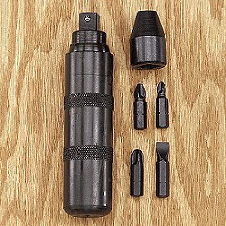

Do you have an impact screwdriver?

No room for an impact driver, or to spin the carb on the engine.
