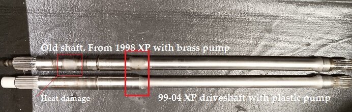

I bought a 99 GSX Ltd. a year ago just after the jet pump was rebuilt on it. I went to go do my first oil change on it this spring and only 1 of the cone bolts were remaining and the oil had leaked out. I decided to rebuild the pump with the 99' kit from OSD and replace the shaft. When I went to put the cone back on the screws from the kit were too large. I read somewhere that in 98 they used smaller screws for the cone. I am concerned that the pump on it was from a 98' and not the original. I used the kit and shaft for a 99'. Will this work or do I need to sort out replacing the shaft and thrust bearing to the 98' style.
Thanks in advance!
