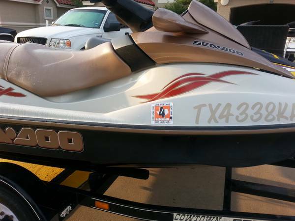

2004 gti le that starts with touching seleniod,,,maybe short somewhere,,perfect condition only 50 hrs with title and trailer
he is asking $2000 for this but I am more interested in why it starts with touching the solenoid. does anyone have any idea what could be the culprit for this?
2003 seadoo le with the same problem in excellent condition and comes with trailer only 50hrs too
two of them with the same problem? doesn't seem right so I am asking the people on here if they know of such a problem on the 03/04 models that could be causing a short? maybe CPU trouble?
Test to see if there is 12 volts on the small yellow wire going to the solenoid when pressing the start button (key installed).
If so, defective solenoid. They are a very common failure.
If no volts, then there could be a slew of things. Start/Stop switch, start relay (not the solenoid), MPEM, short, broken wire,,,
But I bet you find it is the solenoid.
Which is a relatively cheap fix and for $2000 a piece with only 50 hours on them? of course I will do a look over on the machines inside and out, but I have read everyone talk about doing a compression test on them as well. should I try to bring someone with me that knows how to do this exactly? It wouldn't be hard for me to learn, I just have personally never done it before.
