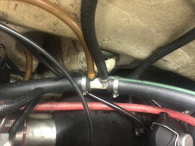

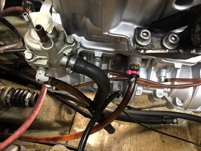

Yuuuup that is a problem. Lines everywhere on these things. :) Take your time and get it right for sure. I have lots of pictures but you can't follow the lines to each end. What lines do you question? Probably be better to explain where they go. This picture is what I do when I am installing the engine before I set it down on the mounts. It makes it easier. Whatever you do, the large black hose on the air pump.... the other end goes to the air filter. Easier for me to tell you where they go. Message me or post pictures of the lines in question and I'll take a look.

Like these, I have to follow them to find out where they end up. Black hose coming of the Double TEE is the Water Control Valve Feed. The hose coming of the WCV goest into the exhaust pipe up front. :D Like I said, easier for me to tell you where they go?

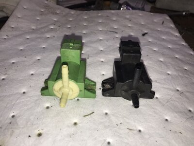

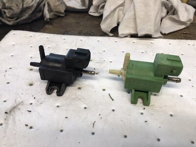

I probably can't find it but I think I started a DI thread a few years back. I was hoping it would be a mecca of information and experience for all things DI. It would be a great resource. The problem I had recently with the one I restored was.... I remove those valves when I pull the engines because they are so fragile. You have to be careful when disconnecting the hoses or installing zip ties. I once tried using the black valve off an RFI but the ski had problems and ran much better when I installed the green solenoid valve. I am tempted to try that experiment again. :)
The BLACK solenoids are easy to find and cheap. Green solenoids are not as plentiful. They look the same... :D :D
I learned that these two were not interchangeable also, from this thread below. Black solenoid is for Carbureted 951's. I am saving folks names for future reference on these DI's as I may be an owner of two in a few days if I can work out a better deal with the PO.

I'm certainly curious as to the differece between the RFI and DI solenoid valves other than the color. LOL The look exactly alike unless the ports are not the same configuration. Basically all that happens is the valve opens and closes. Easy to test. I'm gonna do some research on this.

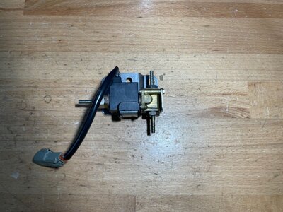

There is also THIS valve which is supposed to be for the 2000-2002 DI. I have one or two of these as well.

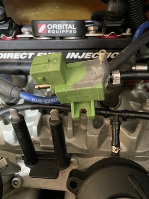

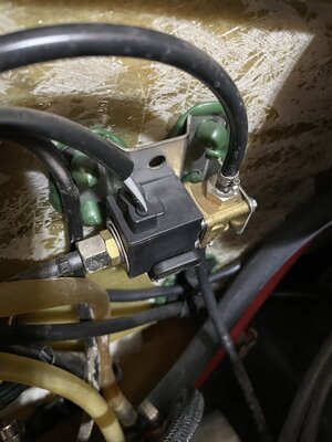

so on the 2001 RX DI, it has the solenoid valve pictured above & attached. The 2002 RX DI has the Green on from PIBREURG; mine has a bit of JB Welded to attach the nipple back on to it. Hopefully that will work.
So unfortunately, having these two waverunners, some things just aren't the same. Assume the perform equally but one has to mess with the connector as they don't match up.

I'd put a very flexible hose coming from the raves onto the solenoid. As little stress as possible would be best.
I'm still curious about the cheaper substitution. These people are NUTZ on the pricing of the green one. Absolute GREED as usual but I digress. If the solenoid works on the previous model year then all things much be equal in the internal department. I mean... all they do is open and close and provide a certain orfice size internally (I'm guessing here or the black on would work).
on your question on the cheaper substitution, the black solenoid valve used on the carb version of the 951 RAVE valve doesn't work. Per forum member "Grayson", he says it won't hold the pressure from the DI air pump
That Carb model would be something to mess with for sure to determine construction and performance. I know the one I tried didn't work but I'm thinking the earlier model from the 951 should work if you modified the plug. It would be a much cheaper route to take.

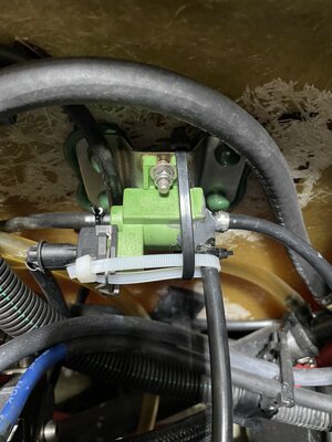

Will test out my JB Weld job tomorrow. Glued tube to nipple, used hair dryer to heat tube to relieve any stress it applies to the nipple as well
my JB Weld seems to work. Engine runs better on water hose; real test in water.
