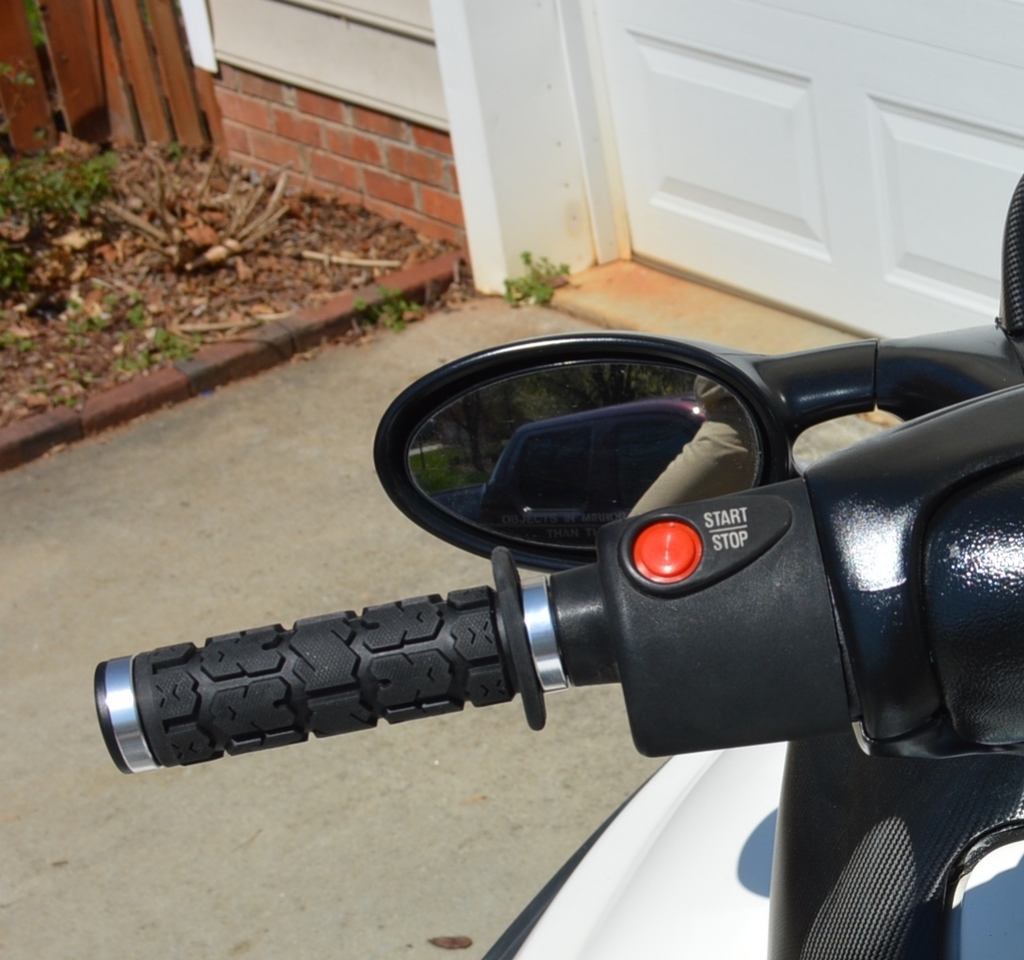

+1 on the ODI rogue grips. But get 120mm ones. The grips have clamps to hold them on. Only the inside clamps will grab the bars, but they hold rock solid. Nice feel. Good for bigger hands.
Caution, I run the ODO rogue on my ski with a stock throttle, however due to their extra thickness, on my 96xp with UMI billet throttle the lever touches the grip before the throttle plates open.
If you have a aftermarket throttle beware, the ODI's OD is too large

For now, grind out a small groove in front of grip where finger throttle hits grip. I am working on finding another solution. Mine goes WOT now but had to groove out front of grip. I have 3 different finger throttle brands to try out this season. UMI, KVPI, and the current blowsion.
[MENTION=72134]1983[/MENTION] - are you using ODI Rogue grips now? Is this the grip that you groved?
Yes, using ODI Rogue grips ( wanted them cause i have huge hands, and the larger diameter of the grip the easier it is for hand fatigue when bouncing around lake ) with blowsion alum FT (finger throttle) I notched out front of grip towards inside where finger throttle pivots too. you could also alternatively grind back of finger grip arm, but grip is cheaper and easier to modify being rubber vs. aluminum if something happens. Didnt want to change strength of finger throttle either by grinding it.

The issue me and [MENTION=62923]Krispy[/MENTION] have discussed and both run into is this: the toss up... you will either have WOT and high idle, or perfect correct idle, and no WOT. of course you want both so i spent some time adjusting 10mm nuts on threaded sleeve at carb adjustment bracket for cable, and nut for adjusting up at finger throttle. I have both WOT and idle now, but had to grind out 1/4" wide / about 1 " long area on my grip beneath where my index finger pulls the finger throttle back into grip. You could never really see it, and next one I will use a different method to grind out ( i used dremel and marked area where to grind ) while its on ski. I will mark it and remove it on next one for a cleaner cut area.

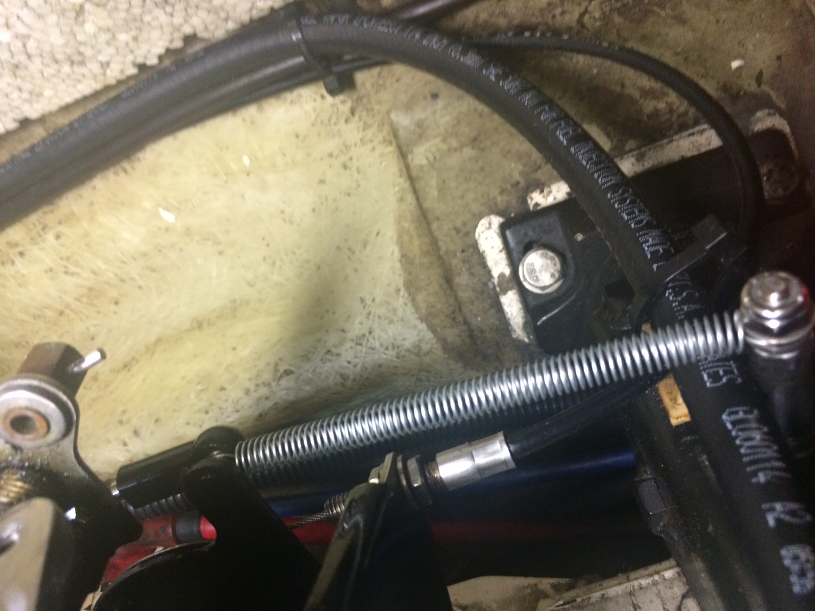

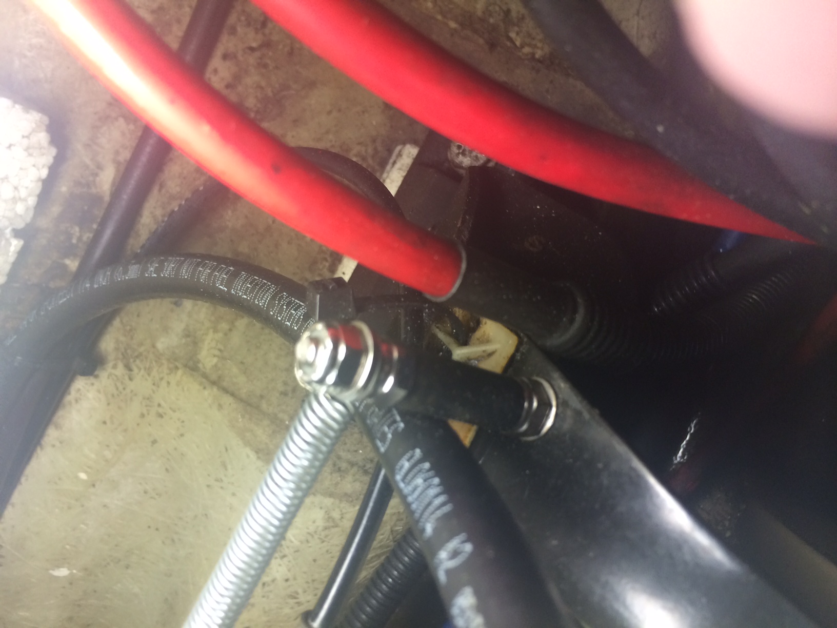

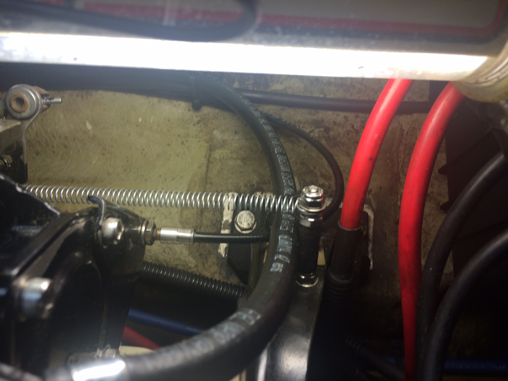

The other little item I added to my 96' xp is a throttle return spring setup. I will post pix in a second. The factory mikuni return springs are the ones on throttle shaft, over time they dont provide enough strength to return the throttle back after all this adjusting i did, sometimes i had a hunting idle. Unless the throttle shaft is pulled back to the idle screw stop every time, it will hunt for idle, and idle high. i engineered this little package to have it return to idle screw every time, and have a better feel on finger grip. kind of how an old beamer has a heavier gas pedal feel than an average vehicle.
You could always use a slimmer diameter bmx type grip too.
Here are the pix. I went through about 20 springs literally lol, to find one that gave allowed throttle blades to open WOT, and return to idle, and not too hard to pull with operation while riding.
WOT:
IDLE:

That throttle return spring is masking an underlying problem. The stock Mik springs are plenty strong enough to click back a throttle. If not you need to find out what the problem is. These are not carbs on cars, no extra return springs.

I'll have to disagree. Been through this many times on a couple skis with aftermarket finger throttle applications. These old carbs springs that are on the butterfly shafts are tired. If you have the opportunity and carbs are off ski and serviceable you can put some additional turns on the factory bound return springs. But if you want a consistent idle and confident feel to your throttle then I would suggest making some adjustments or modifications. I'm not selling anything, just helping out and giving my experience with them.

If it works for you go with it, it's just not my bag. I've never had an issue with the wound springs and I would never over wrap a spring. I guess what I'm getting at is if you have no trigger connected the butterflies should snap back. If you hook up a trigger and it doesn't do the same something is off somewhere with the cable routing to the trigger or the pivot is too tight or something.
Yup, it works for me. Springs and metal get tired over time. If I have a setup that works good ill leave it alone. But if it needs additional return I'll add it.
Im meticulous checking for throttle cable erosion, bind/resistance.
Rob

Can you post a picture of the groove you cut in the grip? I am getting ready to add a finger throttle and want to see what you are doing. I will post all my results once I get into it. Good to hear tha Matt did not have any issues. I wonder if other ODI grips are smaller diameter. I like the Rogues, but my hands are not huge so smaller ones would work as well.
Sure I can get a pic at lunch today. I honestly would go with a smaller diameter grip if it doesn't bother your hands. Then you wont have as much of problem as i do with getting WOT. ODI does make a rogue patterned grip that is much smaller in diameter, it was for bicycles i believe. they accidentally sent me one regular and one smaller is how i found out about it.
