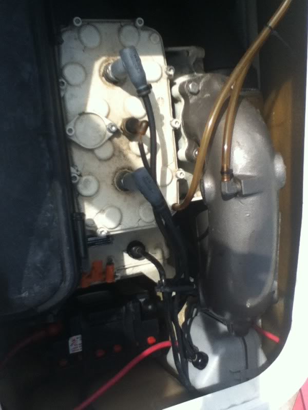

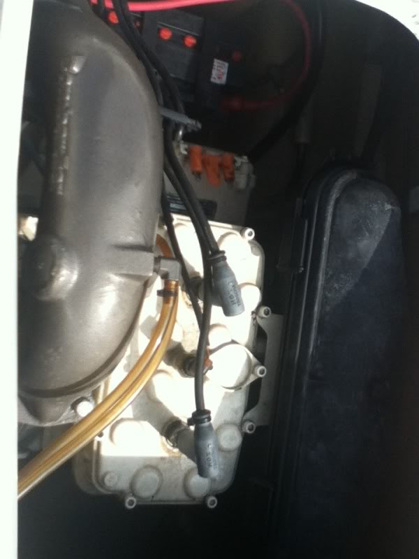

Got it home, picked up a new battery and charged it. Couldn't get the ski to start. had battery power, and spark. just wouldn't fire. I've never touched a ski before this, but i used to work on cars, and shade tree on motorcycle's, so i figured i could manage. All the fuel lines were already replaced w/ inline filters. With the help of lurking on here, and the shop manual, i checked all the proper fuel line placements, checked the pulse line, checked fitting tightness, still no fuel flow / fire. So I'm looking around the engine bay and fuel cell area, and notice this black piece with fuel line running to and from it. i noticed that when the ski was turning over, i could feel air being pumped through it. Upon further inspection, i noticed there were threads on said piece. realized i had found what appeared to be a fuel filter pod with screen in the front dry storage earlier. So i put two and two together, installed said filter, and magic, running ski! lol. I flushed it per manual guidelines, as it had not been run in two years. Now I'm ready to get my tags, and go have some fun!!

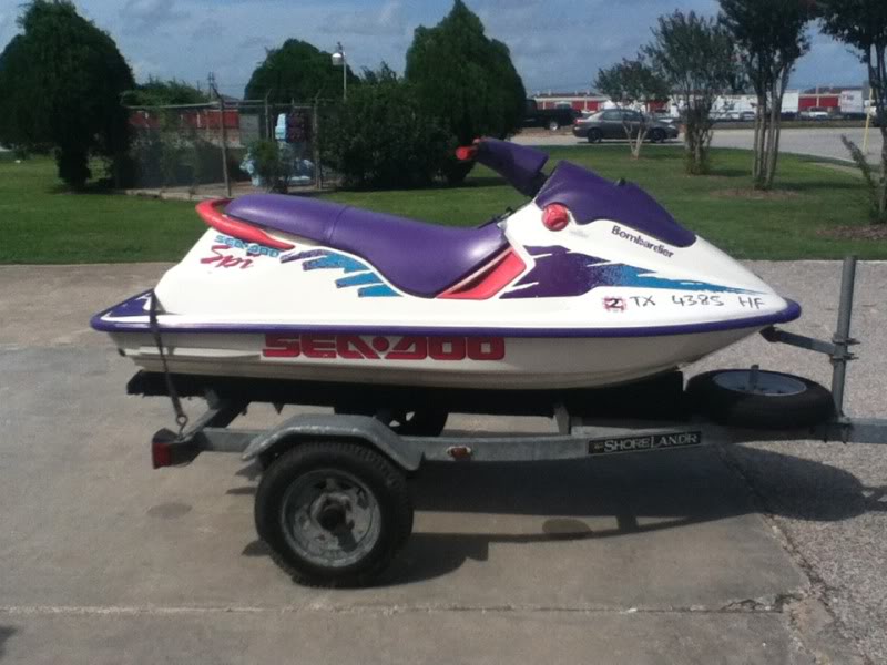

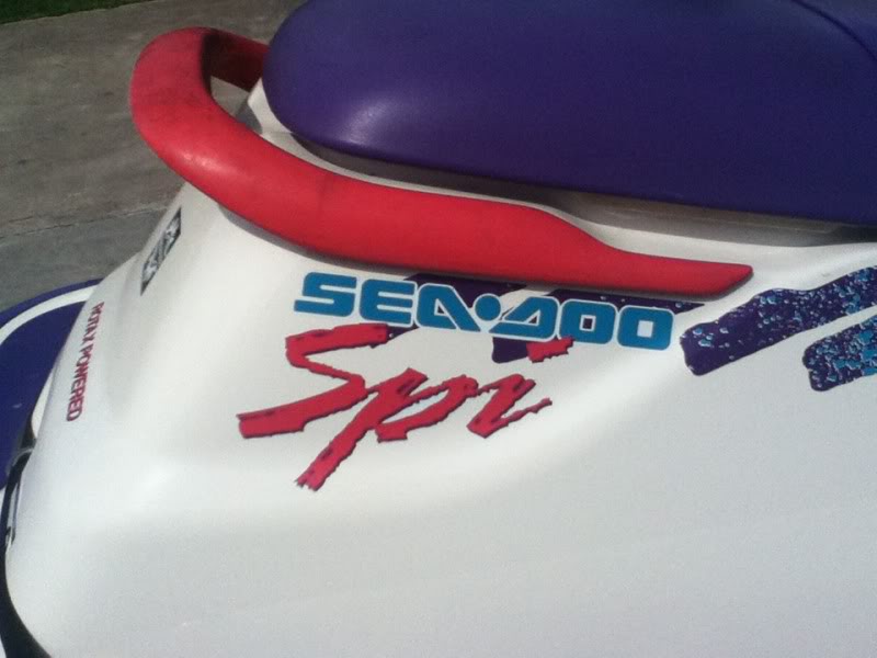

Here are some pics as well, ski is in pretty damn good condition, minus the fuel gauge and side mirror.
