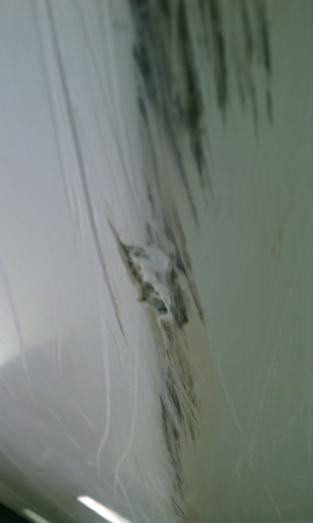

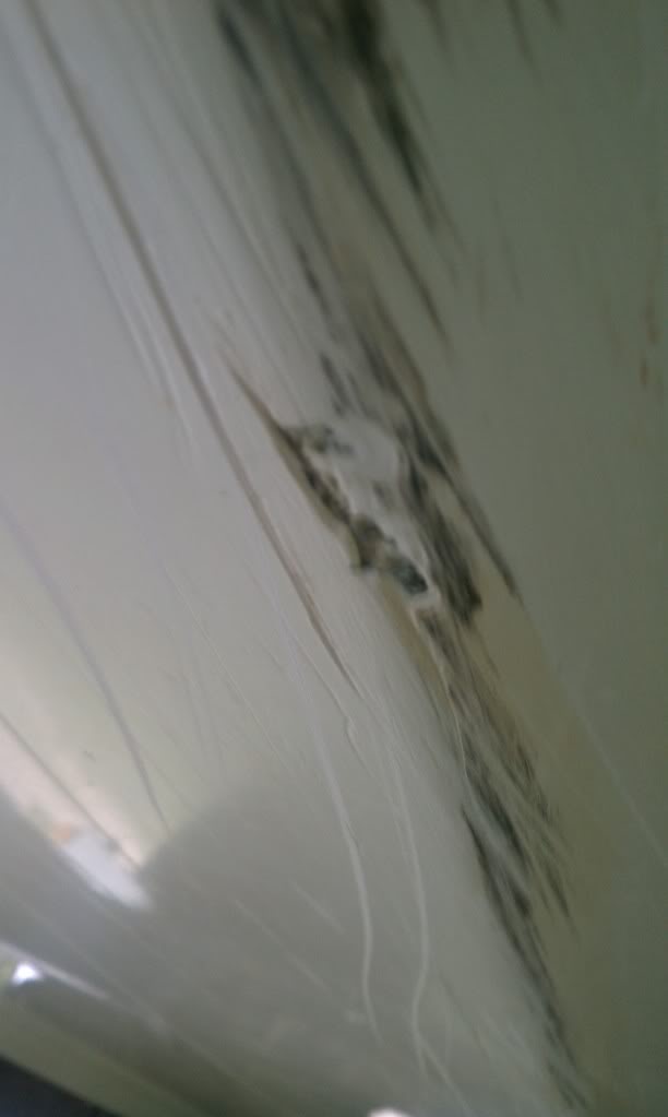

We were boating yesterday and my wife hit the dock or something and it messed up the fiberglass.
What should I do? Leave it alone or do something about it. I don't know if it means much or if there is actually a hole. I know it is a dumb question, its just that I'm clueless when it comes to this.
And if I need to take action, what do I do?
Thanks for your help in advance. :thumbsup:
Ouch, that is a hole that needs fixed. If you left that boat in water overnight, I bet it would sink by the morning. That is going to be an expensive fix. I would find a local shop that does fiberglass repair. Some auto body places will fix boats. I have done the gel cote and fixed cosmetic stuff that is no big deal and it was easy. That has structural damage, not just cosmetic. Others on here say you can do it yourself, so if you are really handy you can look into it. I would expect that to easily cost over $1000 to have a shop fix.
wow, looks more like it was unloaded on the concrete and slid into the water. Sorry dude, but I'd let it sink in deep water and call the insurance company.

I have done fiberglass repair on my old vett and other stuff learned a ton from a friend that taught me how. If you do not know how there are books on it. You can do it yourself but take your time and read as much how to as you can. A shop will run 1000+ for that.

That's a tiny hole, I wouldn't even worry about it till after the season.. I'd put some 3m 5500 sealant in there, and then search the web/you tube on how to fix it with epoxy & either gel coat or paint, it's a pretty simple repair. You're not going to spend $1000 repair for a $4000 boat, not worth it, it's on the bottom when no one will ever see it.. :)

Back to the "tiny hole". Did you look at the first picture? That is not really just a tiny hole that can be filled with epoxy.There is structural damage that needs to be repaired correctly with fiberglass mat. It just happens to be on the part of the boat that will be striking other surfaces almost every time it is out. I almost guarantee if you fill it with epoxy and just cover it up, it will fail again and he will have the same problem again.
I have full coverage oon my 12 yr old boat. 226 bux a year. If I blow it up, sink it, or it catches in fire, at least I can salvage the 6k agreed upon price.

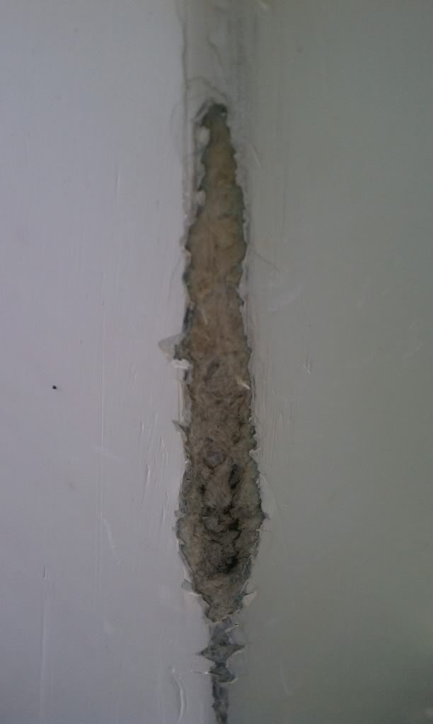

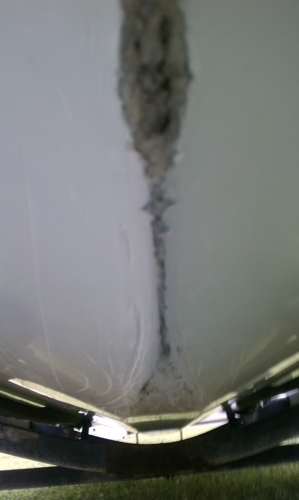

Yes, I looked at the picture and that's a small hole, here's mine that I repaired last year. It was about 1 foot long hole/crack before I started cutting out all the damage, even larger after..The damage from on the OP is probably from the dock or trailer, that area is normally out of the water when on plane anyways..

Secondly, to me that is not a big hole, now PARROTHD's hole, thats a big freaking hole, geez, unbelievably you fixed that yourself!
