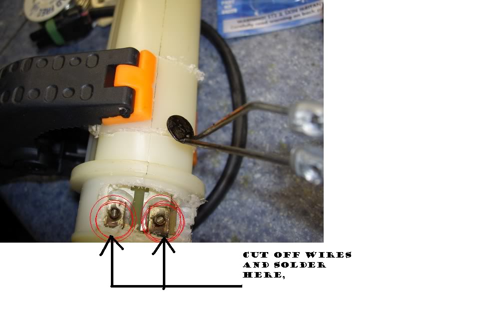

Fuel Gauge fix with no F1 fuse
So I cut my baffle apart and had no F1 fuse. Which from what I read today, other people have had the same problem. What I found were the wires going into the the top of the baffle had corroded and and caused a high resistance. What I did was cut off the wires going into the baffle, and soldered them the the two large spots on the circuit board,
