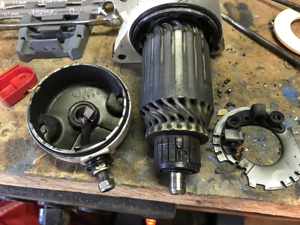

I did some speed runs and the GSX hit 55.7 GPS and the GTX hit 50.1. I think Smamu's finger throttle needs to be adjusted a little. When I got home I pulled the starter apart and found this.
The little copper balls on the bench are actually from the armature! At first I thought they were bearings, but they were melted bits of copper. I guess the brushes wore out, and then the strips shorted out and melted! I guess there is no rebuilding this one. Bummer. Hope my spare lasts a while.
