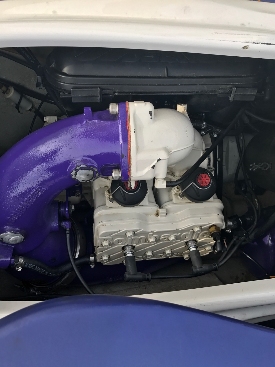

Ok guys, here are a couple images and I'm not seeing the idle screw as expected by the diagrams.
Am I blind? Lol
the carb(s) are on the side of the engine, you are looking at the end of the engine. I think your carbs are on the starboard (right) side when looking at the seadoo from the stern (rear).

So I noticed and you can see in the picture that the nut and washer on the throttle cable was loose. I just thumb tightened it. I ran the ski (on hose) and it was running at 6,500 RPM before tightening and now its running at 3,300 RPM. Could that have been the issue all along?
Yes, that last picture is it.You need to adjust the throttle cable so there is about 2mm of slack in it at the throttle lever before it starts to pull.
Also as said previously your oil pump on the front of the engine is out of adjustment.
I also see that you are missing the carg brace and you need to get that on ASAP so it doesn't crack your intake manifold.
Good job on having the correct oil and no grey fuel lines.
Your small oil lines from the pump to the intake are original and should be replaced too as they break and then the engine doesn't have any oil.
