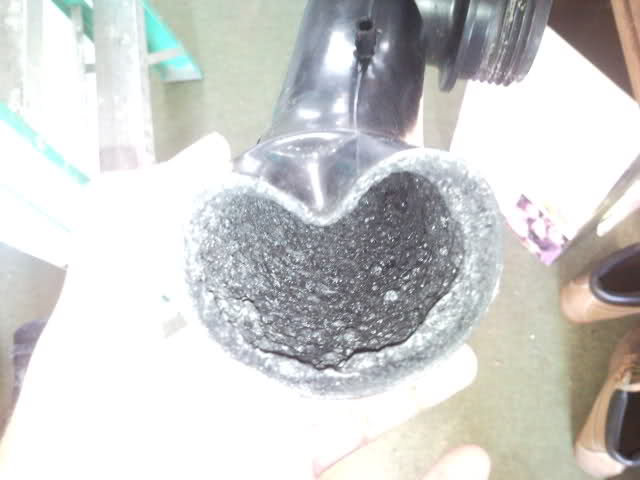

I have some pictures attached of the damage. It seems that the exhaust host that connect the RH muffler to the LH muffler was too close to the exhaust pipe and the double walled hose split, the outer wall was flimsy and the inner wall was blocking most water flow. This seems to have been an evolving problem. I heard a beep about every 20 minutes, but thought this was due to the fact that my LCD guage was not working, guess it must have been the temperature sensor melting. Now I know.
So I ordered two new exhaust hoses, the LH muffler, the exhaust outlet, and the temp. sensor.
So now I guess the question is why did the exhaust hose melt and the walls split? Is the exhaust hose supposed to be that close to the exhaust pipe? It was tied up with zip ties, but it was still touching the pipe.
