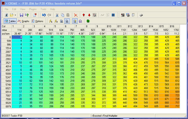

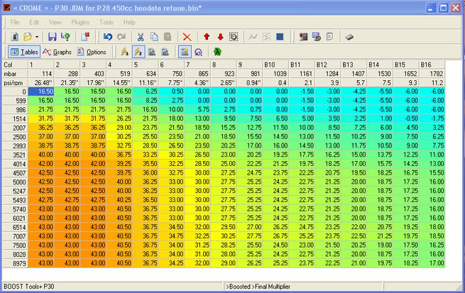

Back in the day... I helped with hacking the Honda computer. (that's were my name came from) And from my limited research... the TPS and port temp sender will cause an asymptotic fuel trim to WOT. SO... a low value, will shift the tables by up to 40%. But if the voltage doesn't rise during mid throttle... you may go lean enough to damage the engine. BUT... knowing that the TPS plays a very small roll in the fueling logic... I'm VERY sure that we can use some other TPS. Even if it's not perfect... it will work.
Once you get your new one... use your meter, and get me a few readings. Basically... it's just a rheostat. There is a main resistor track, and a sweeper. I want to know what the total value is, and if there is any switching for WOT. (some have a switch built into them) SO....
1) I need a reading on MAX resistance (using the sweeper)
2) I need minimum resistance (using the sweeper)
3) I need a reading across the resistor trace.
Then... if you don't mind... I would like to get your old one from you. I will pay the shipping if you would like.
I know this didn't help you... but the research will help others. Especially if we can come up with an inexpensive alliterative.
FYI... here's some tables from a Honda ECU, just for a visual. We added 6 columns to the logic to handle "Boosted" applications. As you can see... the Honda computer also was dependent on the MAP and RPM. The TPS on those engines was just monitored as an accelerator pump application. (Oh... did I mention I'm a physicist who got tired of sitting in a lab??)
