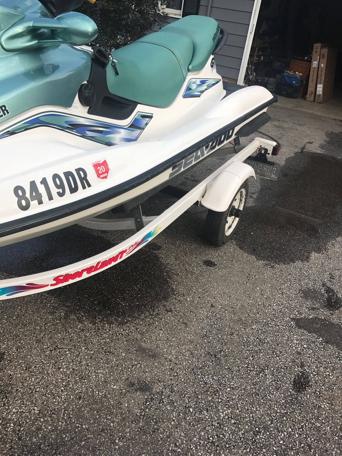

Yes we do like them. Floating forgiving couches. They needed some minor repairs and a battery when we got them. Changed fuel lines and filters. Rebuilt a carb, then replaced one, repaired casting holes on both pipes. Just replaced another battery and a stator / rectifier. Still way cheaper then if we paid full price for the pair and trailer. I like the challenge to keep them up and running!

Still sounds like a good set of skis. It's a nice challenge to keep mine running as well. My motor was in really bad shape when I bought it so I'm actually trying to put new overbored sleeves and pistons in it as well as rebuilding the entire top end and carburetor
