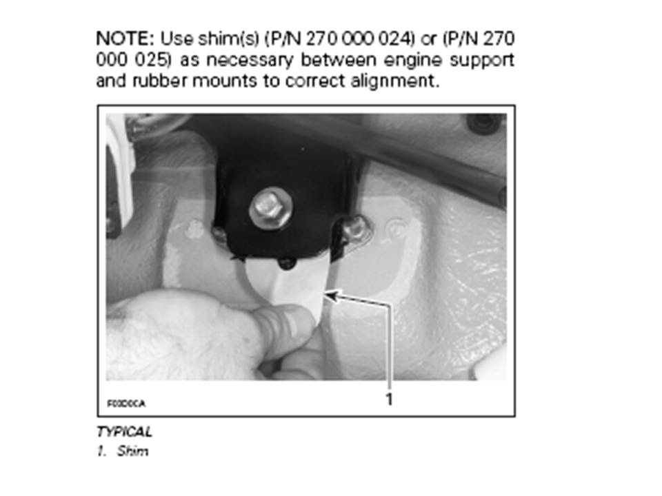

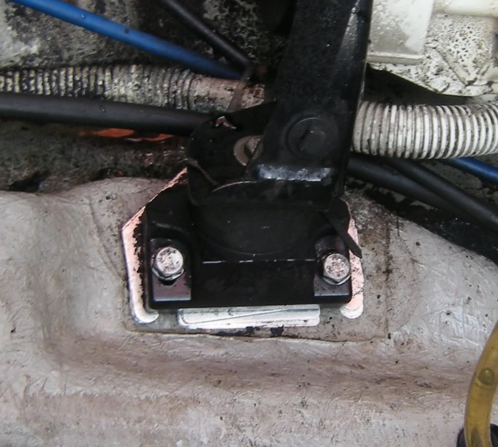

With the engine out, will now be doing to do a complete alignment job. My shims (and there are several) are placed between the rubber mount base and the hull (not between the rubber mount and the engine (which is how the shop manual shows it)). Is my configuration typical? My mounts look differnent anyway from the manual so maybe they changed things up a bit. The shims do appear to have an OEM look to them.

According the the parts diagram the shims go between the hull and the motor mount.

Yep, my stuff matches the parts diagrams. Hopefully it will go back together smooth enough.
