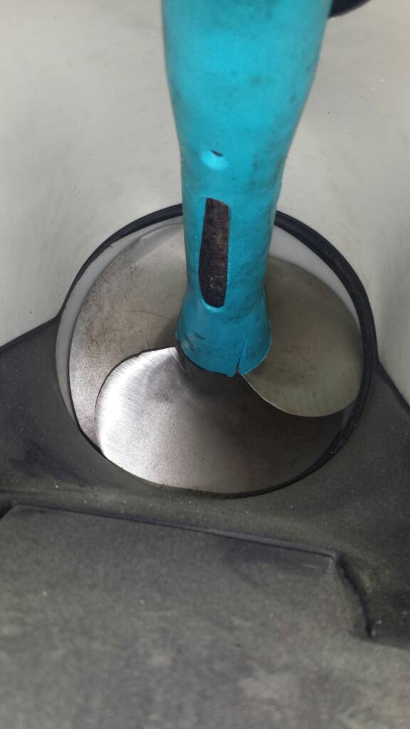

Also checked out the pumps, they actually look to be in good shape, the right side impeller looks to be aftermarket but in great shape. Noticed the left side weedless grate does need replacing as Matt said. Might just change the pump oil and hold off on a full jetpump rebuild until I can really see how she runs.

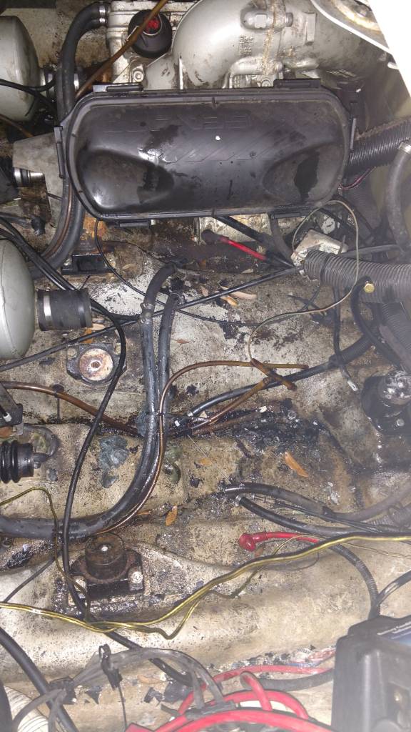

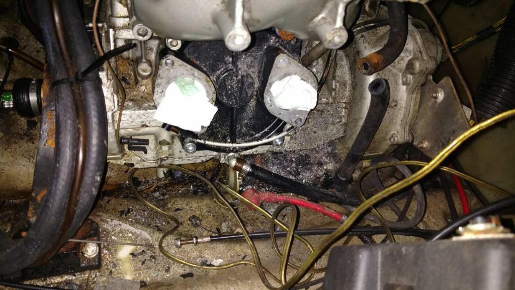

Pulled the carbs..... Call me crazy, but that sure is a whole lot of metal shavings....

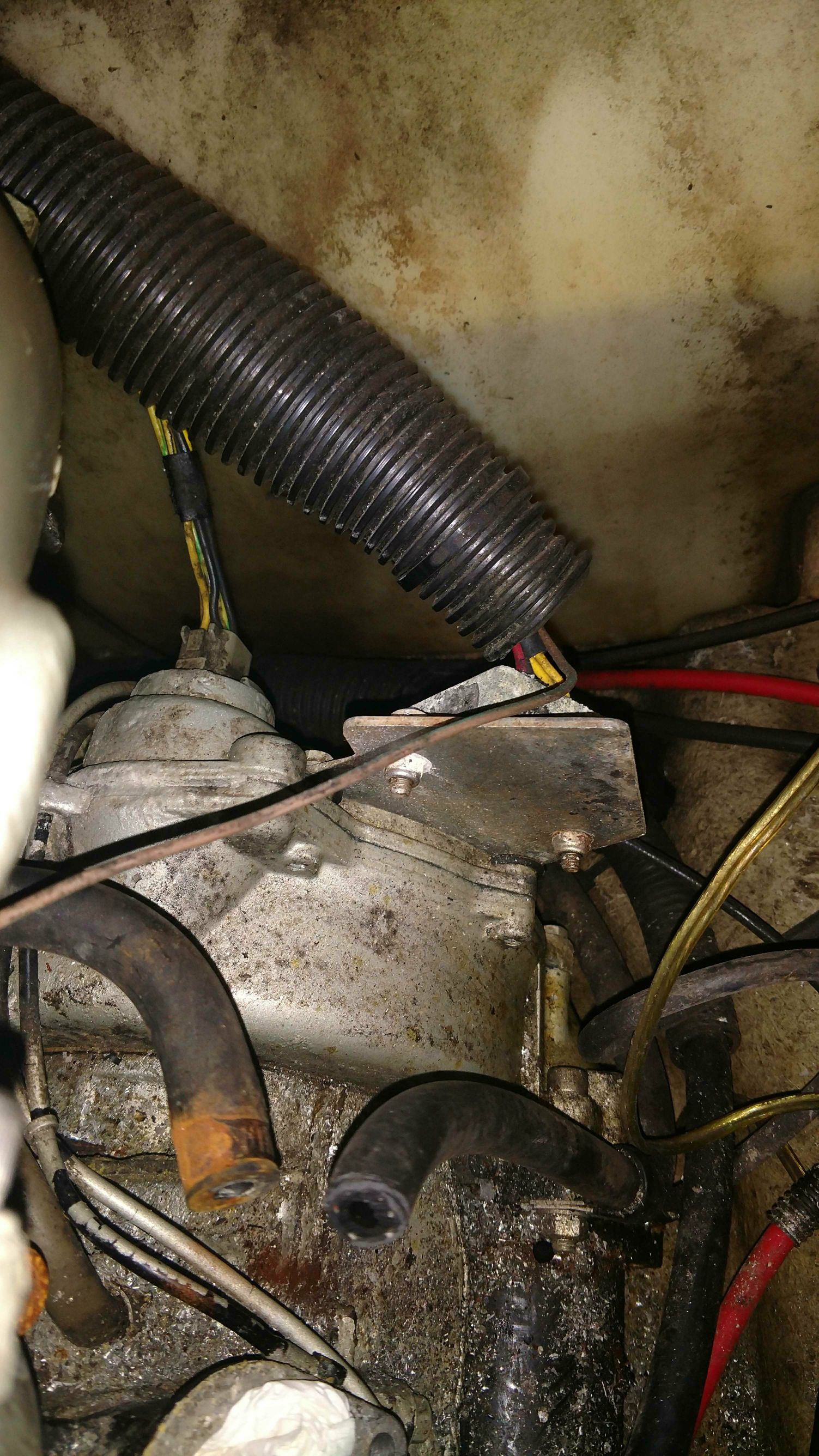

I'm thinking pull the engine, it looks toast from the bottom up..A lot of rust and crud. Does anyone know if a regular 787 will plug and play? Looks like a lot of extras are attached to this motor that I've not seen on a regular 787 from say an XP. Like this..
And this...
Yes a 787 is a 787. Those have an external fuel pump and it looks like the voltage regulator is mounted there as well. I've got a used engine in good shape I'd sell for $500. I also have pistons, gasket kits and anything else needed if you want to fix that one.

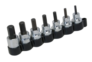

Talk about a pain in the a$$. I didn't have a long enough Allen to remove the stinger so i had to remove the whole big bit*h, pipe, stinger, and all as a whole....without removing the engine cover. Never, ever again.
Those allen sockets are a lifesaver. I have them in 3 different lengths. Too bad you are in FL, I have a spare engine hatch in my basement taking up space.
