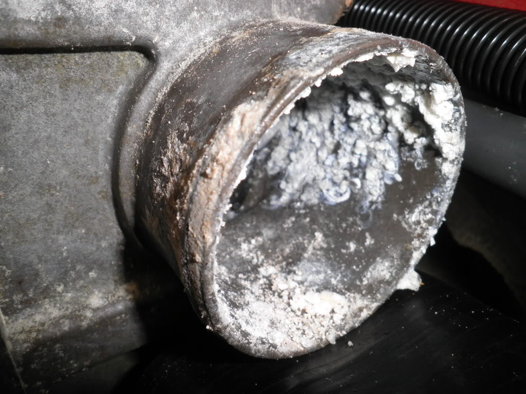

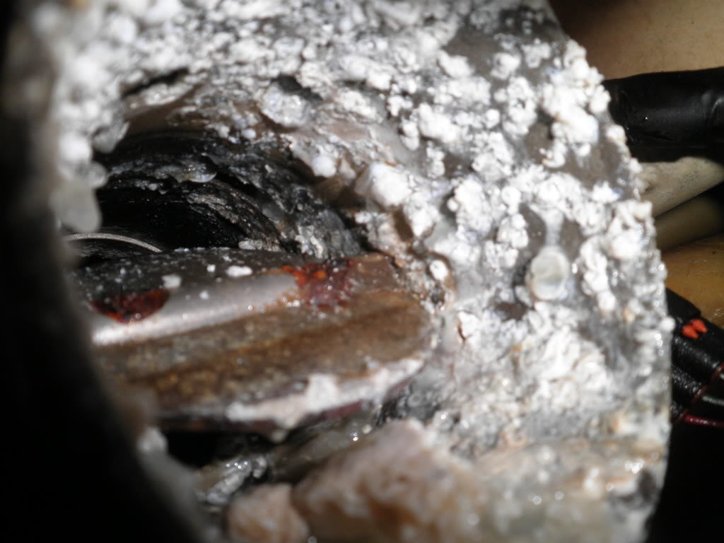

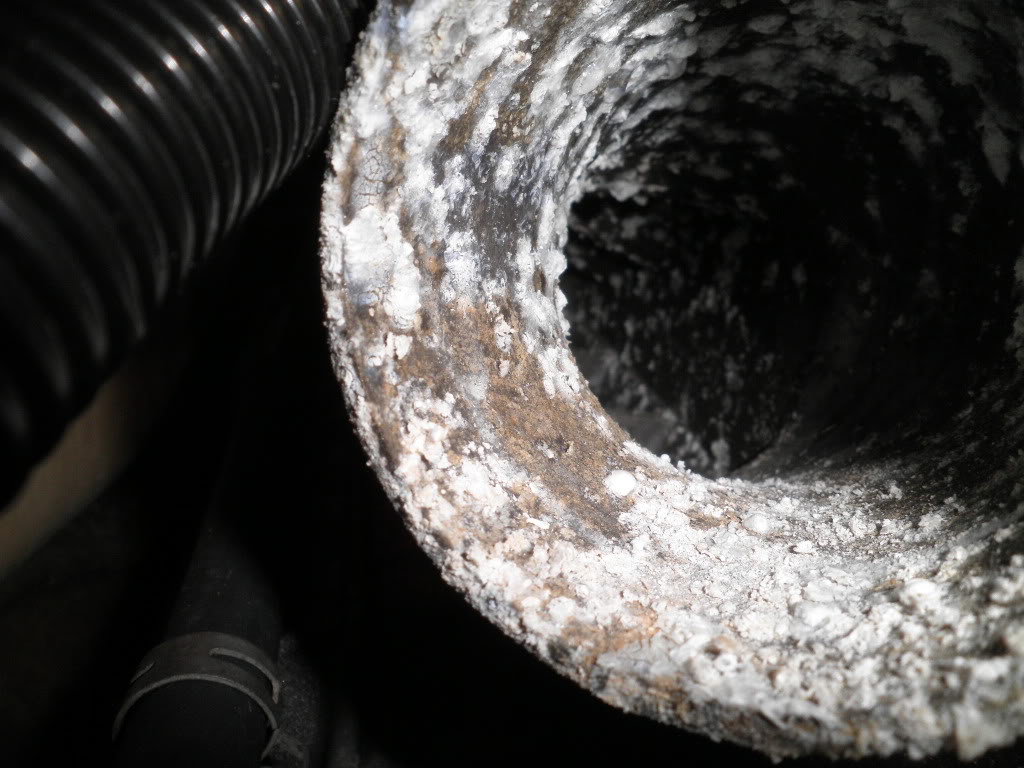

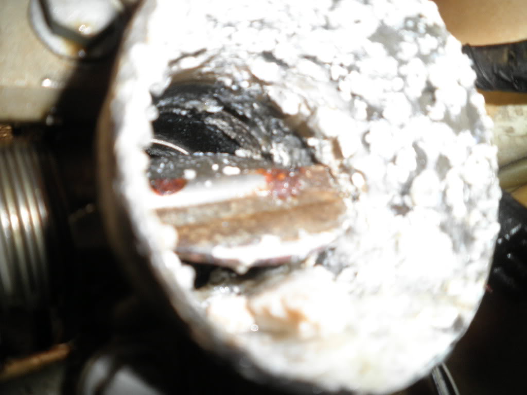

I had to share this. customer came inn and said his ski will not go over 35 mph after his last repair...so I look up history and find that the last time it was in was 2009...I ask him why is he just now bringing it in, and he tells me that his truck has been broke and he has been busy. I tell him that I cant do much about warranty on last repair after this long of time. He tells me he has extended warranty and should cover whatever is wrong with it...make a long story short this is the first thing i find when starting to look at it....My next call to him was who else rides the machine but him? Tells me his daughter took it out a few times....I really doubt she took this out a few times and it was not running right the day they brought it back into me..REALLY???? I dont think so...had to call him back and tell him warranty does not cover sinking it 2 years ago and leaving it till now. If you sink your ski and dont know what to do to clear it out...take it in and tell them right away. I only looked up 3 parts for this and was over 5,000.00 no labor or other parts
