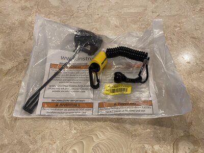

Has anyone had a problem with the 2022 Sea Doos not allowing more than one key to be programmed? My wife ordered a DESS Post and Key from the Sea Doo website and the local dealer could not program more than one key to the machine. She mistakenly got the key with post module, so not only are we out the $60 for the key, we are also out another $60 for the post module because we are outside the 30 day return window.
If anyone can use a DESS Post and Key, I have them for sale and can ship them to you. Just PM me for details.
