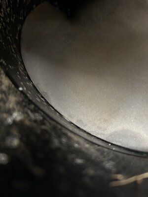

(impeller pics for the helluvit, PO said he replaced the original with a "high altitude" impeller)

Impeller and wear ring look pretty good from your pix.

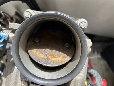

Pic 4- is that your throttle plate? DO NOT start the engine like that. Throttle is open enough to cause the engine to over-rev and grenade. Check for binding linkage or cable.

Throttle plate: don't think it's binding, I remember it rolling the linkage. Is there an adjustment? Haven't looked in there for a week or so because of the snow and temps haven't even hit 50. I'll check it out, but if you happen to know about an adjustment to be made, please advise

Here's a pic of my throttle plate. Looks like it's just a hair open.

Sounds like I need to dive into the throttle plate being as far open as it is. I'm somewhat reluctant to mess with it before getting it wet since the PO said it ran well but I'll at least take a hard look at what could be amiss.

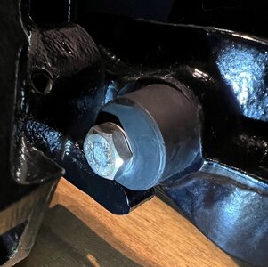

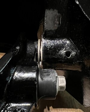

In the attached pics I have installed the one remaining bushing on one side, and the space you see between the bushing and the washer is the only remaining gap (note the holes for the trilobe pins). I would say that if there were a bushing on the other side, and if both bushings were new, that there wouldn't be much play side-to-side. However, there is still plenty of room around the pivot bolt, so I expect plenty of play up and down, but it won't be metal-to-metal anymore.
Also, in the pics... I just saw this... there are bumpers on each side to cushion the reverse gate when it's moved all the way up. One of my bumpers is completely worn flat and the other one was off center, so they were no longer doing their job and there are gouges in the bucket. I think I can just reset the bumper one one side and rotate the bumper on the other side.... You might want to check the condition of yours as well. But if I can order them I will prob just replace them, they feel like hard plastic... assuming they should be softer and may have hardened over time.

With your encouraging words, I tapped one of the pins halfway out while still on the boat. Couldn't get it back in lol, so I guess I'm well prepared for when the bushings come. Anticlimactic, thought it would be more difficult. Great news that only one has to come out.
Regarding the bumpers, mine appear untouched. One is also off center and I think that one is the stop for upper movement and the other for lower. Could absolutely be wrong about this though. Based on the extreme wear, I'd look at the reverse gate adjustment. Here's a pic of where my gate is in neutral--note that I don't know if it is adjust correctly since I haven't got it in the water yet.

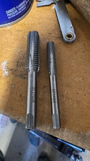

I used a tap to clean the threads for the pivot bolt and bumper holes, they really needed it but mostly it makes me feel better. When I reassemble I will use red loctite (271) per the manual. See attached pics...
