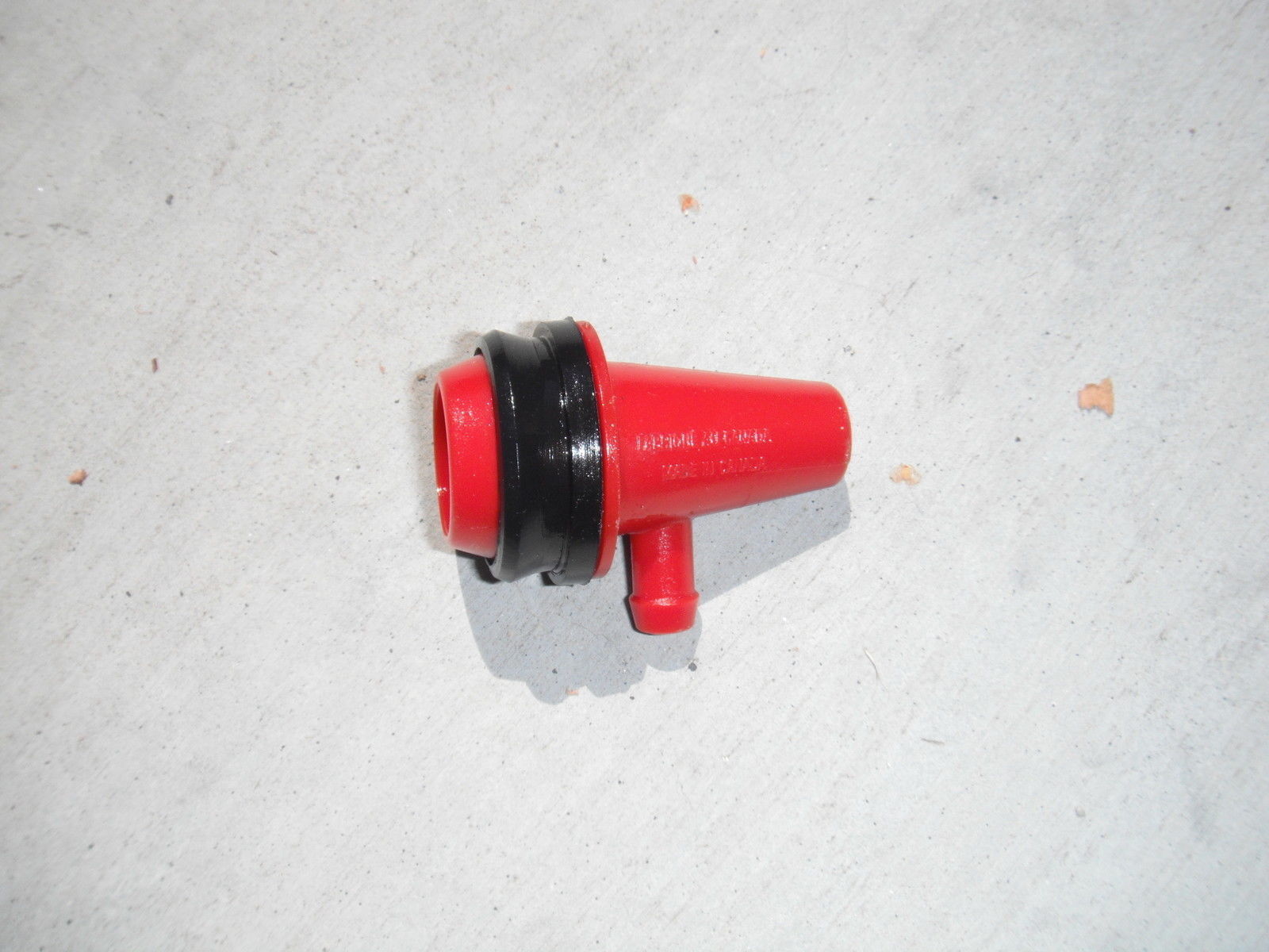

if you have a leak there are two likely sources.
the grommet is leaking (most likely)
the tank has a crack (less likely)
my guess is grommet if you get down there with a flashlight you can usually locate a buildup of black gunk right near there which is an indicator.
They run about $12-15 on ebay.
depending on your model, it would look similar to this, the black part is the issue, they fail over time.
You mentioned an oil leak... Don't forget that you need to keep your rotary valve gear lubricated. You will still need to keep some oil in the injection tank, so unless the leak is actually in the oil pump section going to premix wont help. Spimothy Leary is right to check the tank grommet. I had a similar issue a few years ago and fixed it with a new grommet.
and yes, since you need to lubricate the gear anyway, you'd have to either
a) repair the leak
b) loop the line and check/fill it semi-often. (very rare if your crank seals don't leak)
either way, the grommet should be inspected, since it fails pretty often after 15-20 yrs... the seamed tanked crack now and then but the fail rate isn't as frequent as the grommet.
you can also find seamless tanks for many models if that's the issue.
