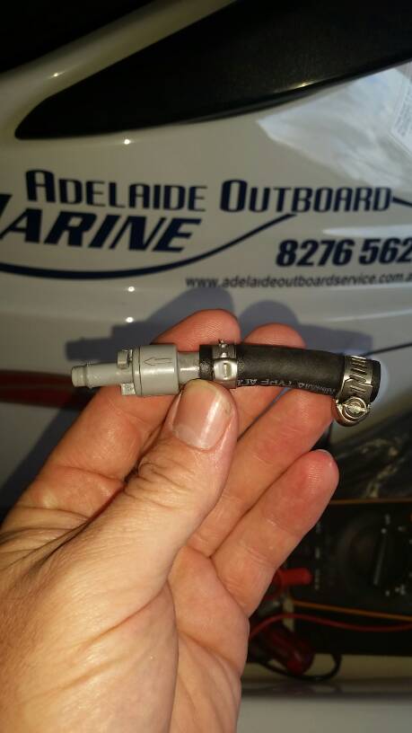

Can someone tell me if the one way check valve that is used for the RAVE Valves can be easily blown through one way with your mouth?
I took mine out just to see if it may be blocked and couldn't blow through it. Is this normal? I can squirt wd40 through it but not blow through it.
Cheers
Kris
Sent from my SM-G900I using Tapatalk
So could it mean mine is faulty if i can't blow through it in the direction it indicates with my mouth but with 20psi compressed air it will? I was thinking it should be easy to blow through one way with very little resistance.

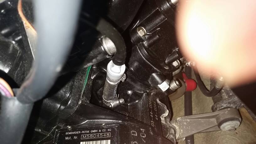

Hopefully this works. The photo that shows it in position is just in loosely.

yours being a newer model that what i had is placed in a different area. your appears to be just behind the pto on top and the one i had was under the off to the side. if i still had mine i would see how mine works. hopefully someone will chime in and help out.
i'm not sure if it is simply a one way valve or works like a pop off valve. meaning some pressure needed before it releases.
Cheers mate. It would appear it needs some pressure to operate but just want to confirm before i buy a new one. Once i rebuild the RAVE valves ill start it up and see what it does.

The arrow goes away from the block crankcase pressure opens the raves.
Can't take too much pressure to open I wouldn't think.
the OP says he cant blow air though it with mouth but will with 20 psi air pressure. do you think it's bad?
No it isn't if i try and blow through it. I tried 20psi compressed air and it did the correct way. I know its supposed to stop the negative pulses and only allow the positive pulses through which gradually inflate the bellows in the RAVE valves. Just not sure if this is the way its meant to operate or not thats all. When i get the rebuild kit for the RAVES ill start it up and see if pressure comes through them i know the RAVES are working.
