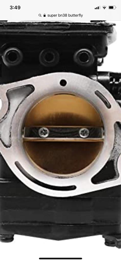

Here’s a Mikuni carb from a 720 for reference. Looking from the bottom up.
