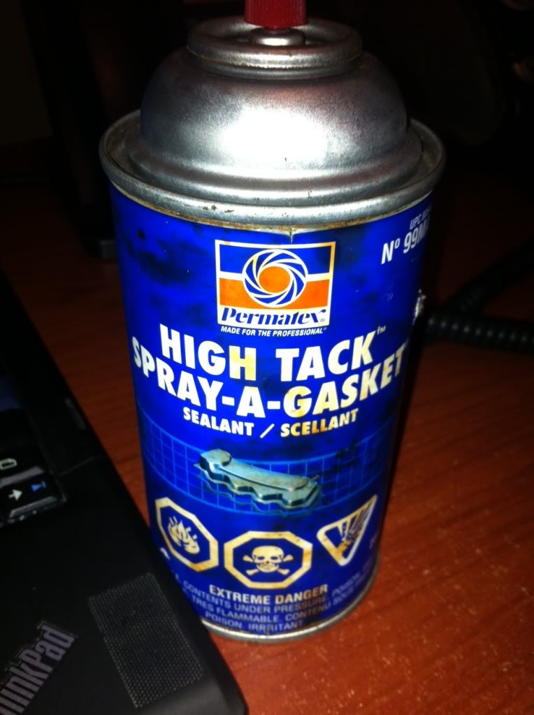

Yes I did ... they can be a pain to have aligned properly so I used this stuff to help hold em' in place.
