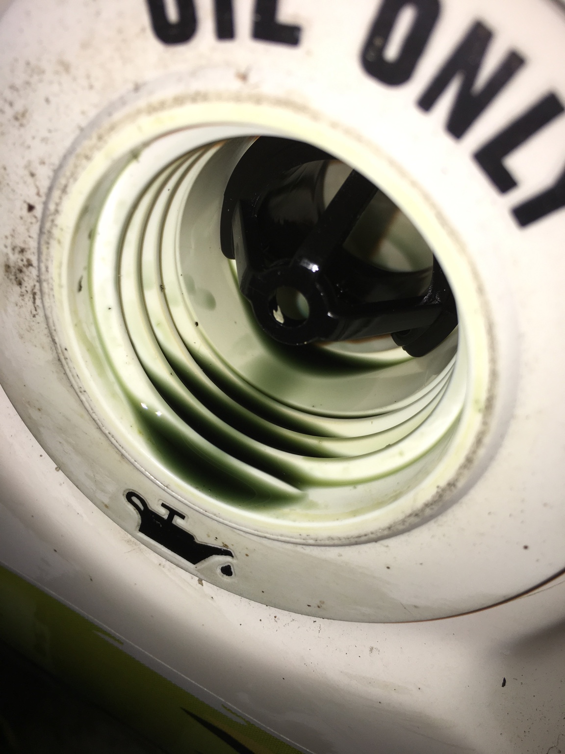

Can anyone help me identify what type of oil this is?
In a 1997 GSI with 720 engine. Trying to determine what kind of oil this is. It has kind of a thin consistency and smells odd, it's more of a green color not really blue. Is it twc3 or API-TC? By chance can anyone ID it based solely on the photo? I know this is kind of a dumb question but thanks for the help.
Based solely on color, it's the wrong oil. Unless they gave you a bottle of oil with the spec on it assume it's the wrong oil.
Thanks guys. I'll drain it out and replace filter. Do I need to worry about getting oil out of the engine itself or like the Rotary valve? Or just drain the tank and lines and refill?
I would suggest getting as much out of the rotary valve an flushing a little correct oil through it. The wrong oil in there has been known to make the inner crank seals leak.
