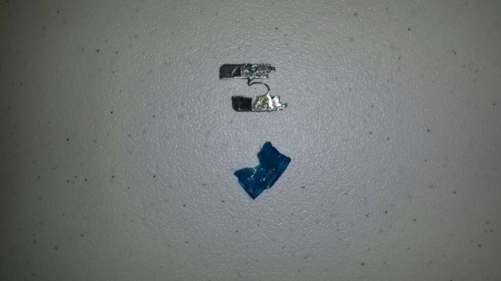

So almost burnt the 97xp to the ground today. I recently have been chasing a bad connection because my ski won't turn over well with brand new battery. So I checked fuses, vts was popped so disconnected vts wires and replaced fuse just in case. Then checked black box fuse and it was popped so I replaced it and it immediately melts and is smoking etc etc. So I yank it as fast as I can, and low and behold, the vts fuse is also melted. Neither popped like they should've, they just melted....
I'm no electrical savant, any ideas? I left out the vts fuse next go round and replaced black box fuse and everything is back to normal, Still won't turn over well but isn't melting fuses....
Pic of 15 amp from black box, you can see it didn't do it's job of breaking connection very well...
The VTS has two sets of wires. One for the motor and one for the module. Did you unplug them both?

Do the check out procedure for the stator. Your popping the 5 amp main fuse still? The repair manual is on the net for free. It has check out procedures. If The MPEM has th 5 amp fuse check that one.
