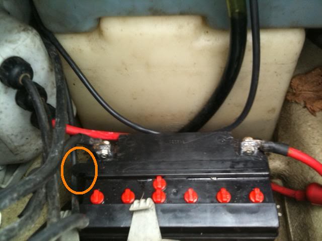

And here's a picture of the battery.

Also... there isn't a vent hooked to the battery, that I can see... and since it's a wet battery... it will spill acid into the hull while you are riding.

Your battery vent is under the red circle. The nipple for a hose is pointing down. Somewhere in you hull... there should be a hose going from that battery nipple, to the rear of the hull.
You battery vent is under the red circle. The nipple for a hose is pointing down. Somewhere in you hull... there should be a hose going from that battery nipple, to the rear of the hull.
Ohhh. Gotchya! Thanks for the info. Does the battery vent hose usually lead to outside of the jet ski?
BTW, I am getting water in the hull. Do you think thats from the bailer issue you were telling me about above (earlier in the thread)?
Yes. On the 95 GTS... in the rear of the ski... there should be a black plastic vent box. (Hooked to the vents in the transom) Some where near the top of it... there should be a fitting that is used as the battery vent. SO... if any acid gets out... it will get washed out the rear vent. If you take a picture of inside the bilge, showing the transom... I'll look to see if the fitting is there.

"flooded" lead Acid batteries require a vent, SLA or sealed lead acid batteries do not.
