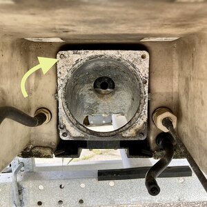

Another step forward another hurdle appears.
I pulled off the pump assembly to access a few things needing repair; the impeller blades, pump cone, and broken assembly bolts. That bad boy was really corroded on- I hooked it all up to a winch and cranked on it while smacking it off with a mallet.
Now I'm stuck with the studs embedded in the assembly, shown above. I tried vice grip + P.Bizzle unscrew them out with no luck. Extractor drill bits are worthless too. Also cut a slot in the top and unscrew with a flat head blade with no luck.
SO either I trailer it to the pros to have them remove the broken bits or pull the whole b!tch out and replace everything I can. Both options comparable in price. The pump cone and stator vane component are really stuck on which makes me want to throw it all out and start with something I can actually access. The impeller seems to be held hostage ..
All this effort and the drive shaft coupler is still stuck?? I really don't know why it won't spin- there's no driveshaft in it where I though the problem was. I can't imagine having the motor in the hull engages it some how. I may have to take this Q to a Yamaha specific forum o_O

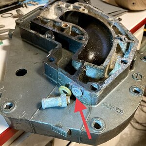

I realized the fuel leaking mentioned in an above post is coming from this hose nipple- its snapped off and squirts a bit with each turn of the motor. I don't understand it's function though- parts catalogue says it's an oil fitting?
Looking at the replacement pics I guess this fitting just pushes in?
I don’t think this is the answer to my ignition issue but I’ll go about fixing it
