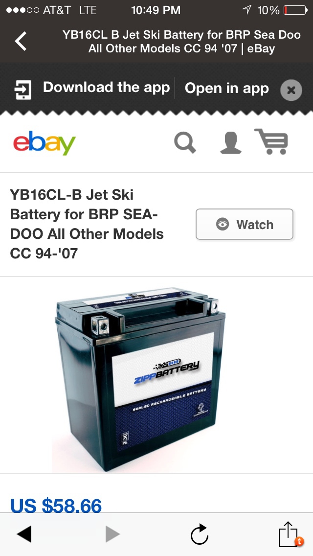

looking for a battery came across this http://www.ebay.com/itm/YB16CL-B-Jet-Ski-Battery-for-BRP-SEA-DOO-All-Other-Models-CC-94-07-/271054117896?pt=Motorcycles_Parts_Accessories&hash=item3f1c159c08&vxp=mtrgood price and sealed and good warranty could this be too good to be true??? Battery im currently running is a napa 16cl-b and i would go back with that but thinking about trying this one out any others heard of this???
I use the exact same battery. I am on my second season with it and have had no complaints. In fact I just installed a new one yesterday, purchased directly from chrome batteries website and it was cheaper than their ebay store.
