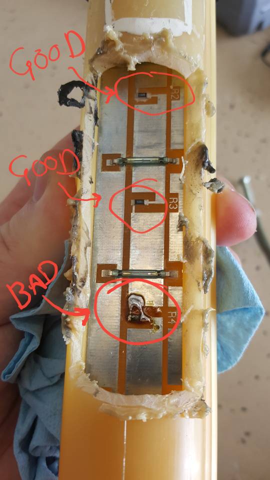

Hi All, I'm new to the forum and PWC's and have been reading everything I can to get up to speed (pun intended) on the in's n out's of the Seadoo's. I am working on our first ones (97 GTI & 97 GTX). I can't thank everyone enough for the repository of knowledge being shared! After reading about the F1 and making the repair my sending unit still has a problem. About 3/4 tank (37 ohms) resistance my sending unit goes open, meaning no continuity. It's almost as if there must be a break on the board. Another member mentioned he has been able to free up the switches most times by moving the float back and forth. Does anyone have any experience with this? Old float and new float stop both have the same result. Is it worth cutting into the baffle again? Suck it up and deal as it's only a fuel gage? Replace the unit? I look forward to reading the replies (funny or serious, I try to learn from them all!). :cheers::biggrinjester:
