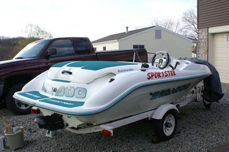

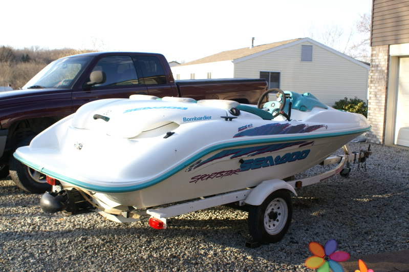

I know I've posted these before... but Here's before and after of a couple projects.
None of the gel is new paint. It was all rubbed out with 3M compound, and it will look new.
FYI... it will make a mess, so wear old clothes.

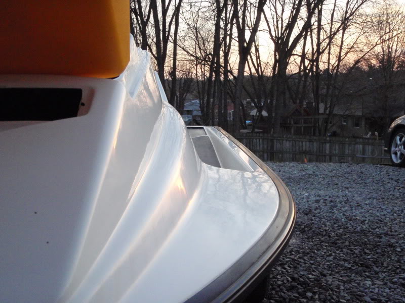

Im in a good spot since my brother owns a detail shop. A couple of steps and my old dried out SP shines again. The gray hull was almost white, and the top was all chalky.

Dr Honda Can you give me some more info on how you shined up that boat? I have a 1995 Sportster that looks like your did before.
How long do you estimate it took to buff and shine the entire boat?
What buffer did you use?
What process? Did you just throw some compound on the buffer and go at it? Did you follow up with a wax or anything?
Also did you get a local shop to recover your seats? Was it pricey? Mine are in bad shape and i cant find anyone selling any.
Thanks for your help.
