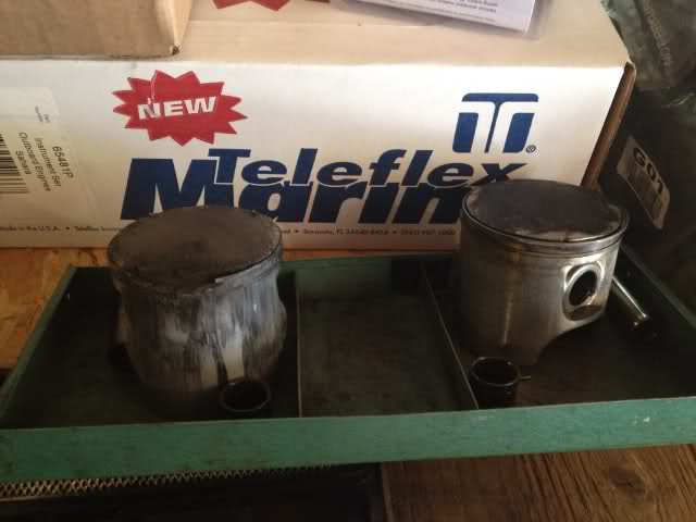

The mechanic we take our stuff too is as trustworthy a guy as one can hope for, he recently rebuilt our early 80's 75hp Mercury outboard and the thing is like a brand new motor, one turn of the starter and it starts up every time. He's a high performance outboard guy, he's got a great reputation on the lake so when he takes apart my XP's engine and tells me the thing was never really rebuilt, I believe him. Here's the picture dump.

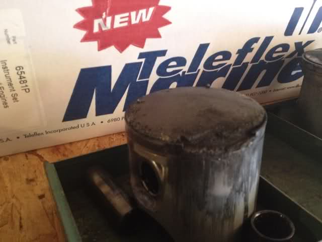

As you can see the piston is quite fried, amazing SeaDoo makes these things with such a small space between the top ring and the top of the piston.
close up!

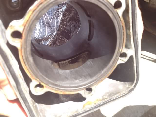

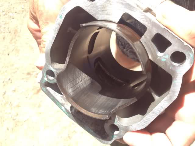

The next few pictures will show the uneven crosshatching on the cylinder walls along with the dark spots that indicate a really really bad job of honing the cylinder, if it was done it was done by hand without giving two s***s.
The oval shape and missed dark spots would cause uneven heat and friction
And the resulting damage of the ring being slammed into the head...

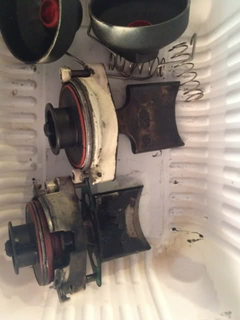

And the Rave's that were only 6 hours old from a fresh rebuild
