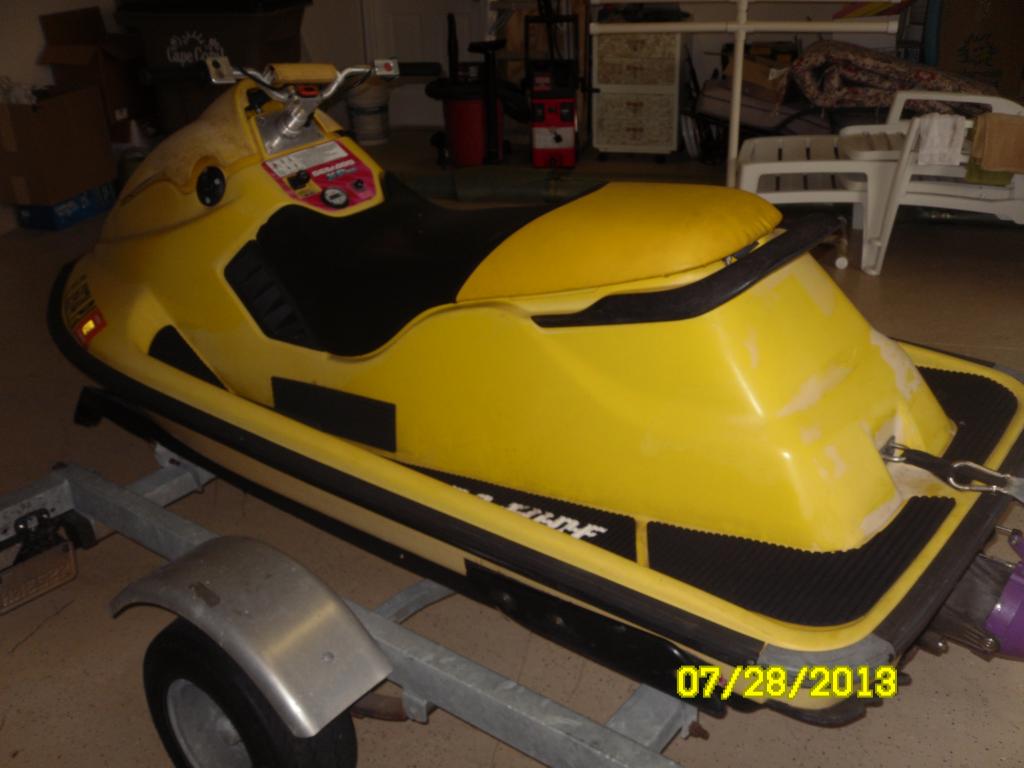

-I found this xp forsale, and this is what I am going for. Stock yoke/stem, and aftermarket bars.....

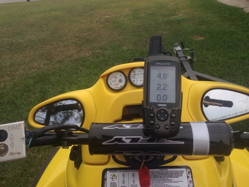

here's my stock stem with some aftermarket bars..
my buddy John's
UMI (IMO, it appears the the UMI shaves off at least 2-3 inches maybe?) just guessing
The first pic of your bars is what im looking for.
Can you give a parts list of what your bars brand are ( looks like ada racing or maybe that's just the pad )
Finger throttle ?
Grips? ( looks like most people suggest the lockable odi grips )

1) parts list... A set of old cruddy bars that my mechanic had sitting in a bucket, (just the pad was purchased)
2) finger throttle (vs thumb) Is my preferred. where you use your index / middle finger to hit the throttle vs your thumb, it might give you the feeling that your an inch or two further away. you will see the finger throttle in pic 1, vs how your's should look if its stock with the thumb throttle on the other side of the bar.
3) grips.. ODI rogues are my personal favorite. Also In pic 1. But everybody has their taste.

I ended up with a set of Renthal bars from a dirt bike. They were blue anodized and I painted them gloss black. I had ODI rogues on for a while but I found with my finger throttle the throttle "arm" was actually contacting the grip, not allowing full throttle. I ended up changing to some BMX grips from walmart. They work fine.

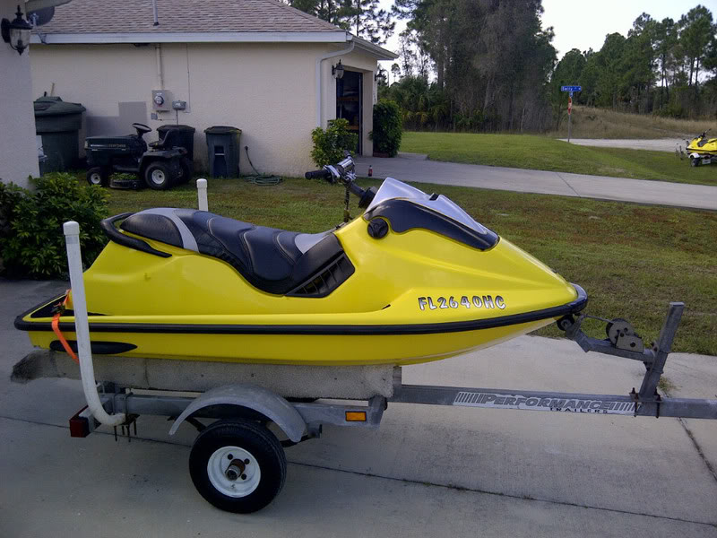

To the OP here is a pic of my aftermarket bars on stock stem
krispy has a very similar setup, it will spare you a couple of inches, and sometimes that makes a difference. and IMO just throwing some shallow bars on the stem, removing the pad, finger throttle will certainly make a difference.
umi, much more expensive would give you the extra inch or two that will help further.
