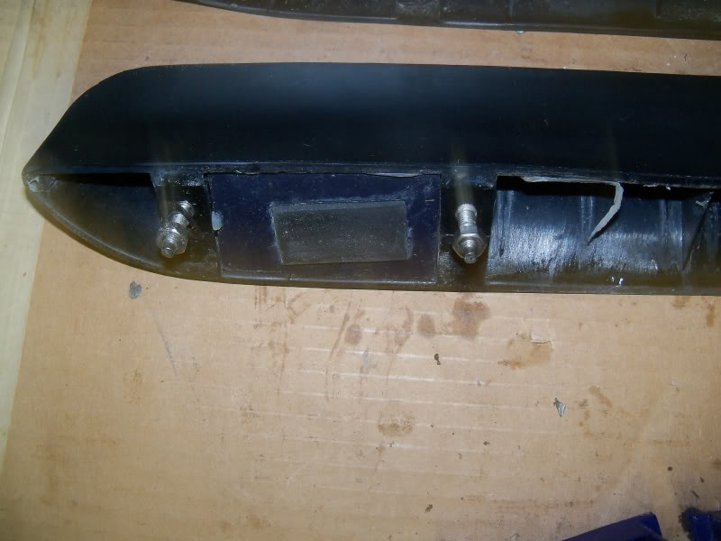

I have had them break on a gsi and a gsx. The gsi had the exact same thing happen, first a crack, then a triangle chip, and it has not broke since the triangle portion broke. That was 2 years ago. Now on the gsx they both broke right off. The hull had no damge on either of mine. Replaced with oem used ones. I know [MENTION=41828]Minnetonka4me[/MENTION] has them. I will be buying some off him soon. I just bought a 96 gsx off ebay and am driving to IN to pick it up and it has a broken sponson. This time I am going to fill the sponsons with a closed cell foam I bought when redoing the stringers on my boat. Hopefully that will help. I think it will. Behind the sponson there is open voids where it seems there should be some sort of brace. In the gtx sponsons there is braces it the open voids.
Here are some pictures of the gtx sponson and their braces.
The gsx should probably have had them also.
Yes...it would definitely help. I also think they work loose over time then the sponson puts added stress on the mounting studs.
