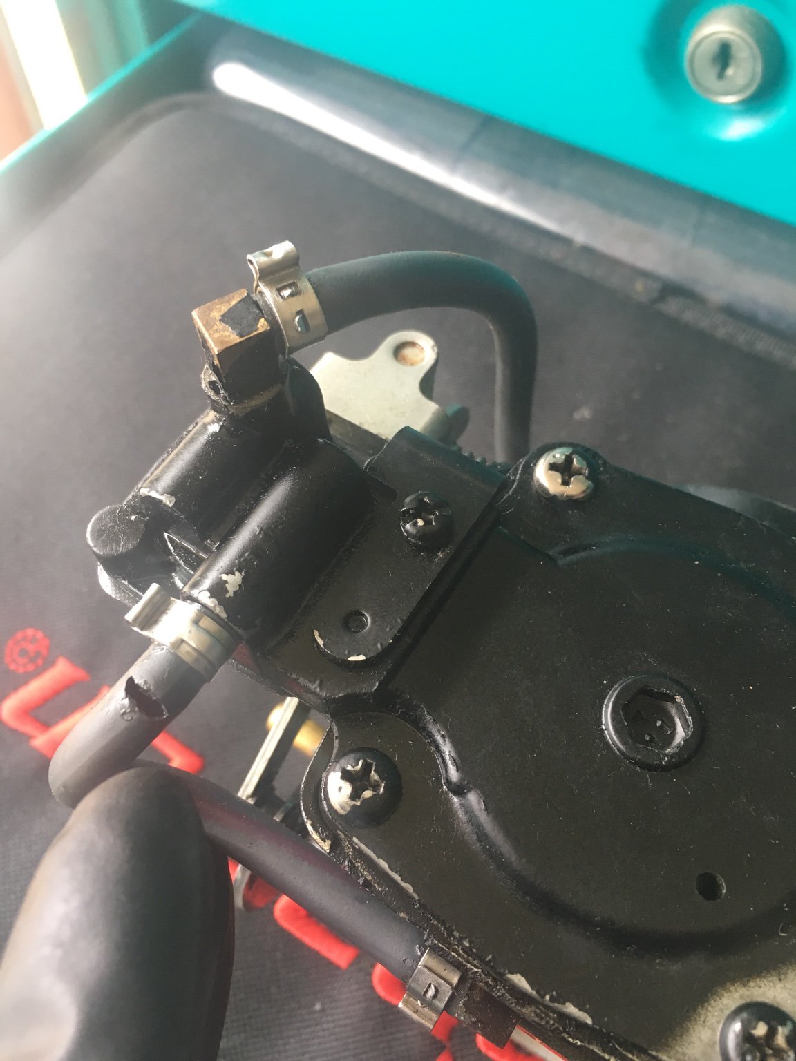

I have an 01 GTS with a bog have to like pump throttle to get up to speed. Took carb off found broke line and the jet in it ,

Rabid...if you want to eliminate that excel pump, cap the fitting on the bottom carb, order up a 1.5n/s assy, turn the ls screw to 1, and hs to 1.5 turns out from bottom. Also ordr a 75 67.5 pilot.....or, get some red fuel min from depot in the lawnmower section, and replace the broken line. Make she to re insert the restrictor(big end to carb)
Does it matter if it's on the end by the carb? You said big end toward carb. Mine was facing with the big end next to the pump. So I just flipped the line around
if it has not been tampered with then the jut probably left the factory next to the pump. I think if it were mine I would flip it back as it was stock.

I fixed hole in line and put restrictor back in big end toward carb, maybe I'll need a new carb too?? See how it runs, have to pump throttle get to mid then jumps to full not a smooth scale from idle to full

Haha.... Being that I think you have a 720, get yourself a 1.5 n/s assy, 67.5 pilot and bend the excel arm outta the way. Turn low to 1, high to 1.5
I got the restrictor part from jess. It is a small plastic part.

Hello... I have good news for once. I finally was able to work on the ski. I added the restrictor to the inlet line of the accelerator pump and I kicked the ski over to see if I was getting fuel to the AP and I was. I then pulled the line from the discharge side and squeezed the throttle and it shot a bunch out. I then checked the brass fitting in the PTO carb and it was fine. The mag carb was clogged so I got out a foot of new line and attached it to the fitting at the carb for the brass sprayer and filled it with carb cleaner and blew the crap out of it. Today I took it out and it ran great!!!! I tried to get it to bog for a good hour and it would jump out of the hole with out any problems and also I tried it at a slower pace with no problems. If definitely was the missing restrictor valve that I was able to get from jess.

Just for additional info and knowledge. Your problem was most probably the clogged brass nozzle on the mag carb. The little restrictor jet is actually to slow the return of the a-pump to resting position so that it does not rob fuel and cause a stall during a dump of the throttle from WOT. I found this tid bit of information when I researched that little nozzle. I ran mine for a whole season with no issues without it after replacing those little fuel lines , but when I let off the throttle it went straight to idle. Now that I have found and reinstalled the brass jet, it comes down to fast idle and then slowly returns to normal idle.
