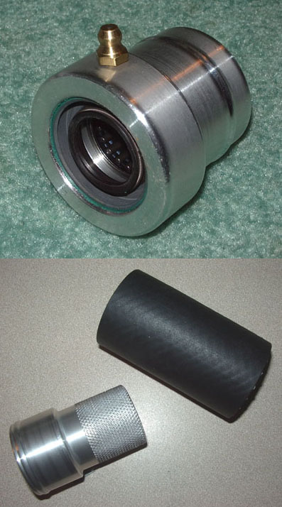

I have gsx rfi and the engine is complete and going in the ski within the next few days and was suggested to replace the carbon seal with a support bearing. Also, here in Puerto Rico people call things by different names than what Americans call them. I have no idea what i am looking for nor where to look anyone know of what i speak?
They are talking about this (less the knurled aluminum piece):

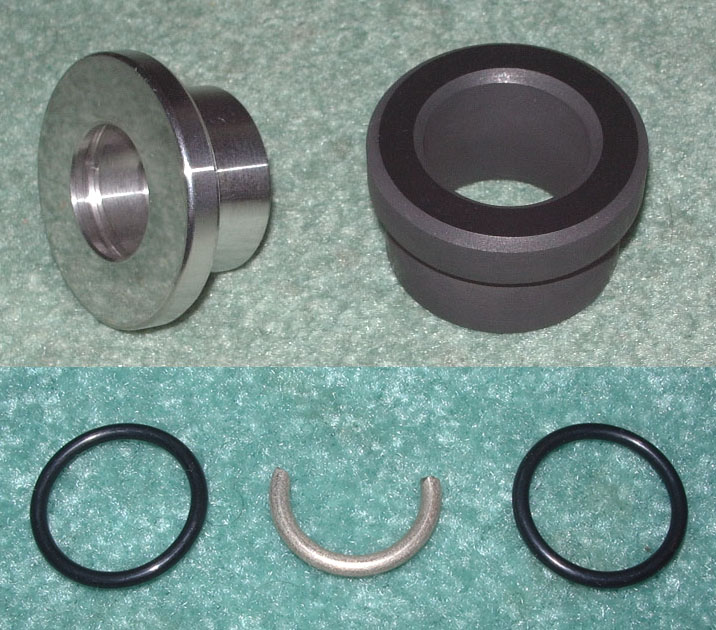

Personally, just stick with the carbon seal. I have been buying the Heavy Duty carbon seal kit from OSDparts.com and a new boot too. It's awesome, zero maintenance, yes the cost is more. If you don't grease the carrier bearing it can seize on the shaft and rip the thru hull adapter out of the hull--thus requiring you to install that knurled piece and a new carrier and a new driveshaft. Points can be argued either way for both. A properly set up carbon set up works just fine.
Here is the HD kit, and the other picture is to show you the difference from stock(stock is on the left).
I have both on my skis I like the carbon seals WAY better.
