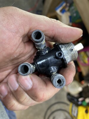

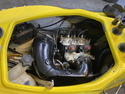

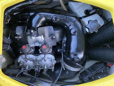

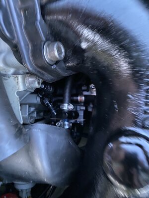

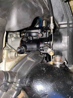

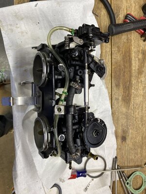

I inherited this 1998 Seadoo xp limited from my dad. It had a blown engine so he had the shop put in a new engine. But it was getting starved of fuel so he put it in storage. 7 years later I pulled it out and had a local guy go thru it and clean the carbs. Last summer everything plugged up on my first ride so I pulled it and put it in my shop till I had time to replace the fuel lines. I have now replace all the fuel lines, new fuel water filter, new selector valve, rebuild the carbs two times, new plugs two times and trimmed the cable on the boots. I adjusted the high side from zero to 1/4 and low I’ve bounced between 1 1/4 to 1 3/4.
The ski starts great and idles at 1400 at start up and sounds great. As soon as I give it throttle it starts to bog down and sputters. I can work the throttle and ever it up over 4,500 rpm’s and it takes off and runs great between 4,500 to 7,800rpms but starts to rattle at 7,800rpms. When I let off the gas and it drops down under 4,500 rpm’s it starts to big down and stall out. But it starts idling at 2,000 rpm’s once it’s revved up. I can pull the choke and it will start to die but will start idle back at 1,400 rpm’s.
I’m clueless to what else to do. Any help would be amazing.
