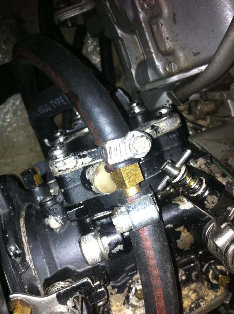

Hey guys newb here to Seadoo's. Owned yamaha's before but this is my first seadoo and its a 98 XPL, here is my small issue. Ok it bogs a little when i WOT out of the hole. The carb settings were 2turns out on the low but now i have done 2 1/2 out and it helped alot. still there but not as bad. I guess the owner before me broke the fuel T off of the carb and repleced it with a brass one and it looks to be smaller then the fuel line ( ill get a pic for you) but the jetski runs perfect at cruising speeds and WOT it goes to 6850 rpm like its suppose to. also when the ski is out of the water if you give it a little rev it seams to hang, almost like a air leak somewhere, didnt know if this was normal or not.

Here is the T i am talking about
That T connector should ok. Try turning the low speed out a little more to fine tune the engine. The 2 1/2 is the basic setting to start with. Also be sure both carbs are in sync with other.
