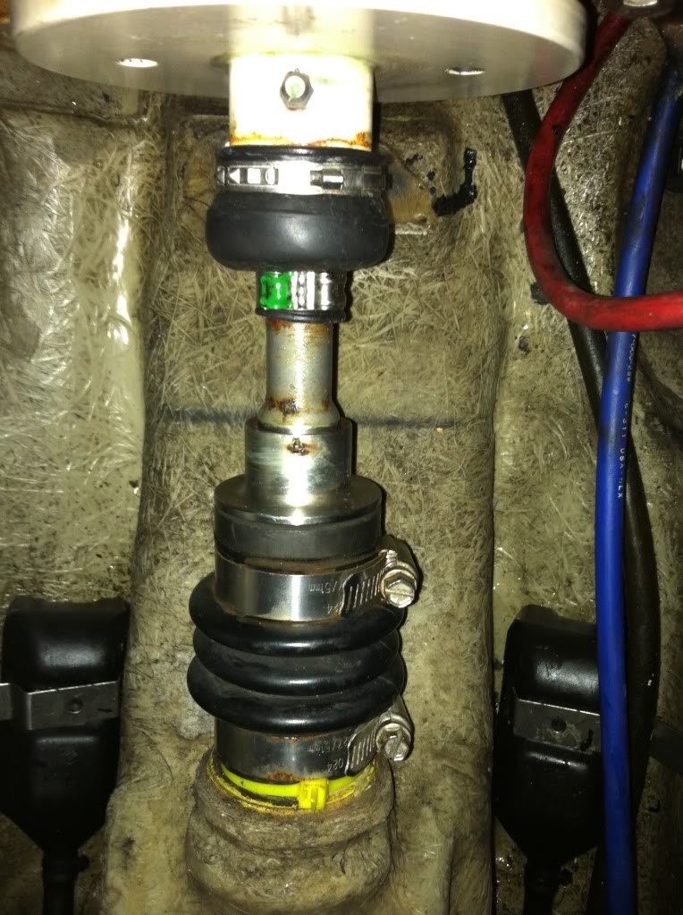

A common item that allows for water to come into the hull while sitting is the Carbon Seal. If the bellows (boot), O-ring (now replaced with e C-clip), or the carbon seal fails in anyways, water will pour into the hull.
There is a second item that will allow for water to enter the hull. They are the siphon tubes. If they are not installed properly water will run in backwards which then fills the hull up.

Here is a picture of the Carbon Seal and the boot...
