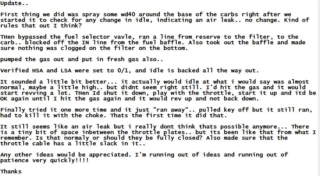

Update..
First thing we did was spray some wd40 around the base of the carbs right after we started it to check for any change in idle, indicating an air leak.. no change. Kind of rules that out I think?
well, it wont let me type any more than 1 line so here is an image lol.. no idea what the deal is
