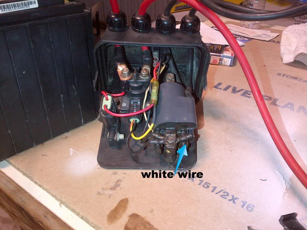

If all grounds and wires check out ok, take the white wire off the coil in the rear ebox and put a meter or testing light on it. If there is a proper signal going to the coil from the mag housing the light will flash as you turn the engine over which means the stator is sending a proper signal to the coil In this case the culprit is usually the coil.
If there is no signal on the white wire like the guys said there is a good chance that the pick up coil inside the mag cover has broken loose, I had to fix 2 this summer
