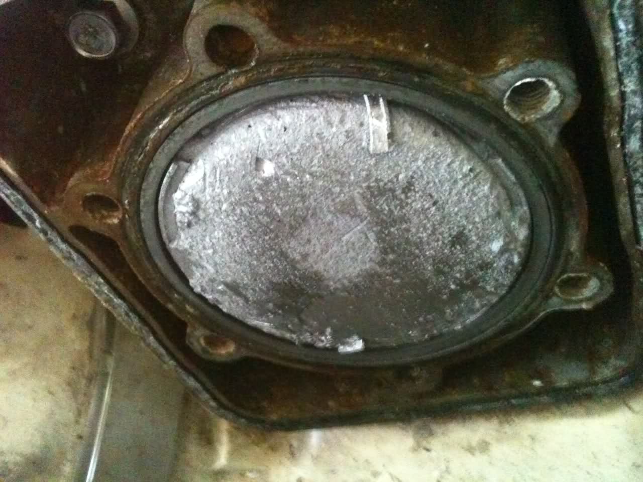

Once you get the top end apart... post a pic of the damage, and we will help diagnose the failure.

The pics speak for themselves. What do i do???
Wellllll....................
Looks like that jug went lean, and you melted the piston crown. That allowed the ring to break free, and cause the damage. Also, the melted aluminum is what caused the scuffing on the skirt.
I would personally do a full rebuild. If that's the original engine... there is no reason to try to save the crank.
