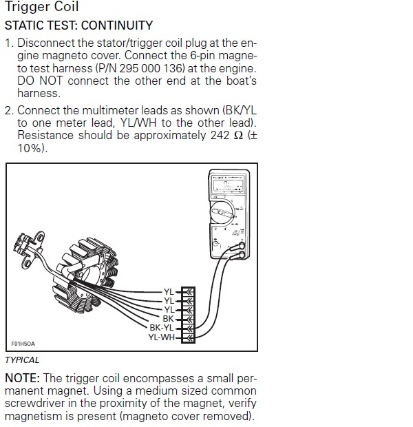

I've been looking for a similar thread. I get a pulse at the white + wire on the ignition coil but no spark to plugs. I've trimmed wires. I tested coils. Both have 0.7 on secondary and one coil had 57 the other 33 on primary.
What should these coils produce on primary side. I'm guessing both coils are bad. Just wierd they both went out at the same time.
I have not looked into the mag cover just yet.
Any ideas?
