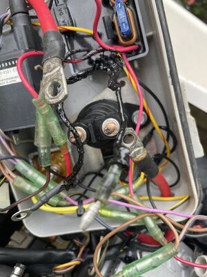

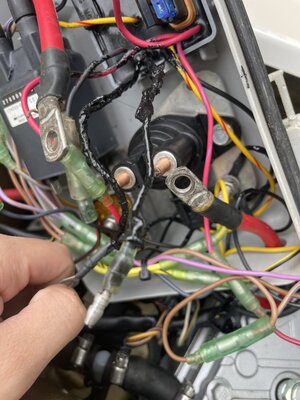

My 96gti will sometimes not read the key and wont start. I have sanded the key contacts, put a ziptie around the key to insure it fits tight on the dess post and have changed out the dess post for a different one that i know works. The biggest problem is every time i think i fixed it with one of those things i listed above, it would suddenly not work anymore after walking away for a few minutes. I dont believe its the key or post because no matter how many times i plug and unplug the key it makes no difference or what way irs orientated on the post, when its working, it works no matter what way i put the key on the post and then it wont work it just wont work.. when the no start condition is occuring the display blinks once and turns off confirming it knows a key had been placed on the post but wont start, and when it does work and will start the display turns on and stays on showing fuel and battery light on. Any ideas on what to test and look for are greatly appreciated, ive been through pretty much every part of this ski inside and out new motor new everything, replaced or fixed yet always seem to have another issue every time i want to ride it… Pwc problems
