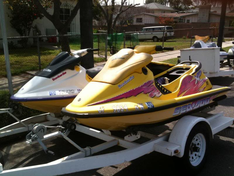

Unfortunately I didn't get to work on my skis today. It came with a battery and I tried to charge it but its not holding 12v on the meter. It was at 9v after charging 12 hours. Also didn't want to take the battery out the 95, which rode like a champ again today, to put it into the 1996 so i bought a new one and its charging right now. Pretty much, I went spearfishing instead of fixing up the 96 XP. Took a bunch of pictures today that I'm posting soon. Most are for the Tigershark and trailer I'm posting on craigslist tonight. After giving it a quick spray with the hose it actually looks a lot better. Got some strange red goo out of the footwells and some black stuff stuck in between the hood and the storage compartment. The hull has almost no scratches. Handlebar pad is really ugly. Looks like black mold on it or something. I'm going to the do it yourself car wash soon with the pressure washer and remove the dirt and stains that the garden hose couldn't handle. First thing tomorrow I want to install the battery and try to jump the solenoid.

Took the the fuel bowl off to clean it and it's brand new. On the 95 xp I worked on, it was so bad we couldn't clean it and bought a new one. Also had brand new spark plugs in it and a full tank of gas. Barely any oil and I'm' thinking it's mineral because there's an empty bottle of mineral XPS in the trailer box. Was going to do the oil intake lines while the carbs were off anyways. Might as well change the oil filter and flush the lines. Read about cleaning rave valves but I haven't even troubleshot the electrical. Getting ahead of myself.
Whoa, the ski actually looks pretty damn clean if I do say so myself, but you do have some work to do. First thing, take that battery thing out, I hope he didnt fry the mpem using that thing. Then of course, you have the grey fuel lines to replace. From the looks of it the engine has never been apart either, I dont see any paint chips on the rave valve bolts which lead me to believe they have never been cleaned, so that should be interesting to see lol they are probably full of sludge
Do you have a charger hooked up to the battery while it is connected to your seadoo? If so do not do that again, when charging the battery take it out of the seadoo. You can damage the mpem that way.

The pump on the 95 extends out farther from the hull than the pump on the 96 XP. Just put them both on the same trailer after putting new carpet on and noticed right away. Looks good side to side. Pictures to come. Spent most of the day replacing the carpet on the trailers so the other trailer with tigershark is ready to go but didn't have time for the 96 XP again.
Just some pictures after fixing the carpet. Washed it as best as I could without a pressure washer.

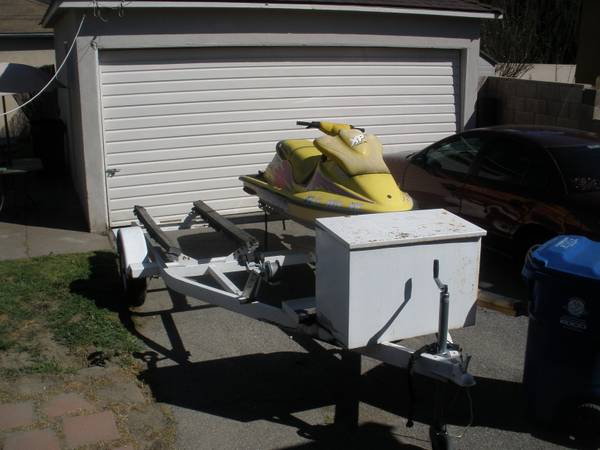

I am definitely doing the troubleshooting tomorrow but first things first. I'm trying to sell my trailer and tigershark. Don't laugh too hard about it being a tigershark. Motor is solid and its a fun ride. http://losangeles.craigslist.org/lgb/boa/3690061870.html
Get some soft scrub with bleach and a scotch pad and scrub the chit out of the hood. A good hour and it will be like new.
