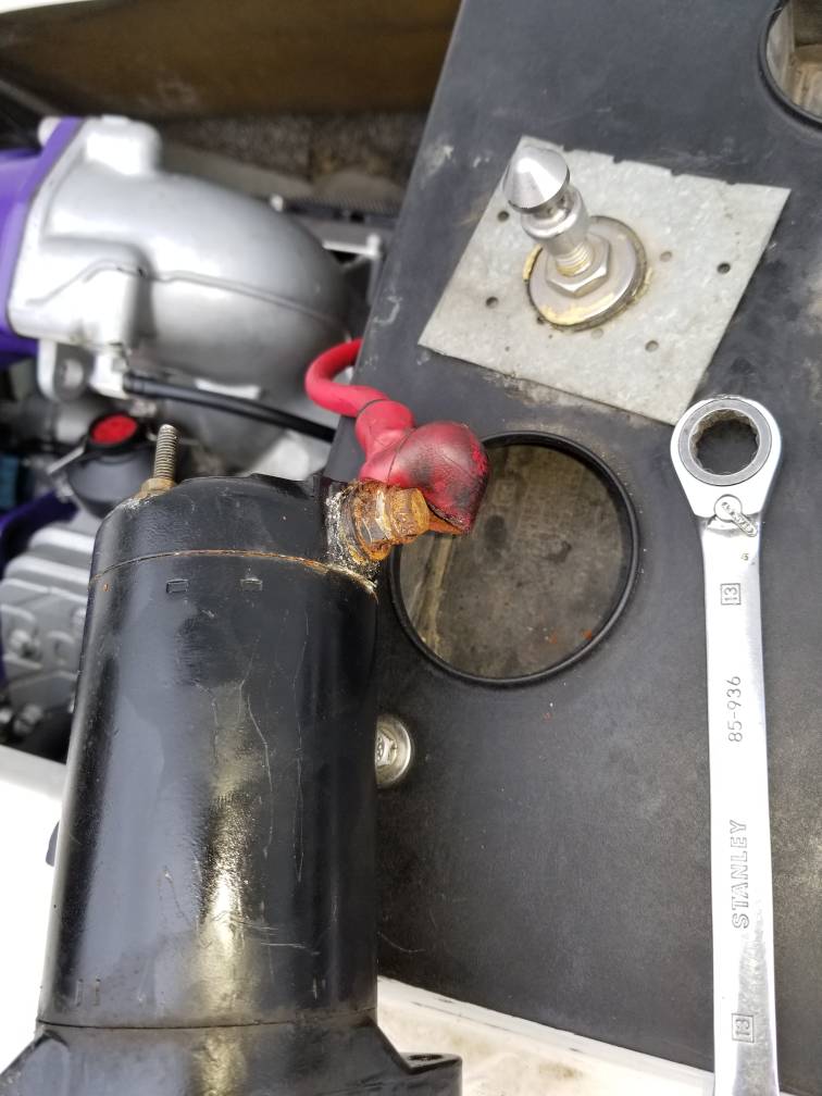

Got the starter out this morning. The rear support plate for the starter was missing. Found that the postive post was corroded pretty bad.
The starter drive was also stuck out. I could hear it snap back once i was wiggling it out of the engine. When you turn the starter my hand, the bearing sounds sound very rough in it. I can turn the engine over pretty easily now.
Is the rear support plate important? If so where does one find one?
Yes the support plate is important. Is that an OEM Nipon Denso starter or aftermarket?
