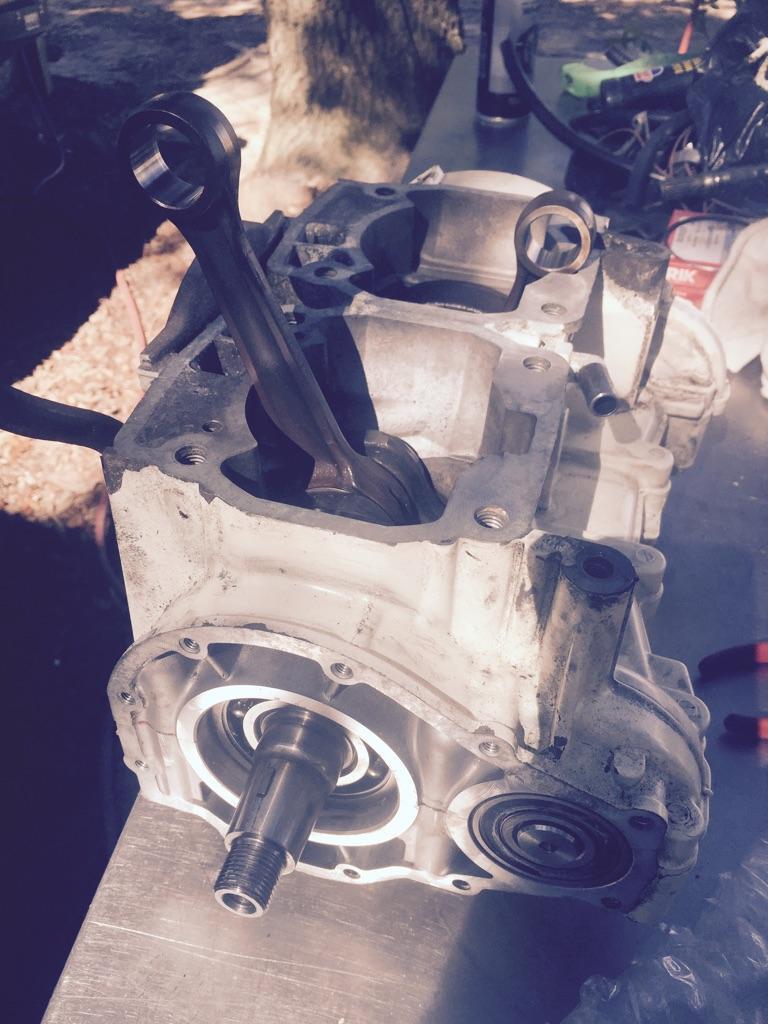

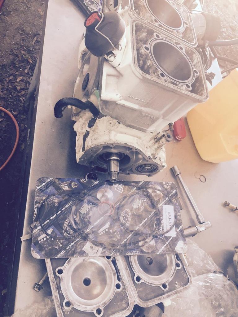

Had the ski out 2 weeks ago, had a great time and went through about 1/2 tank of gas. All was good put it on the trailer and came home. Went out this weekend, long no wake zone then ski would not go over 30mph. Shut it off then would not start. Came home, got it to start but was running ruff and didn't sound right. Also found one of the welch plugs was leaking a little.

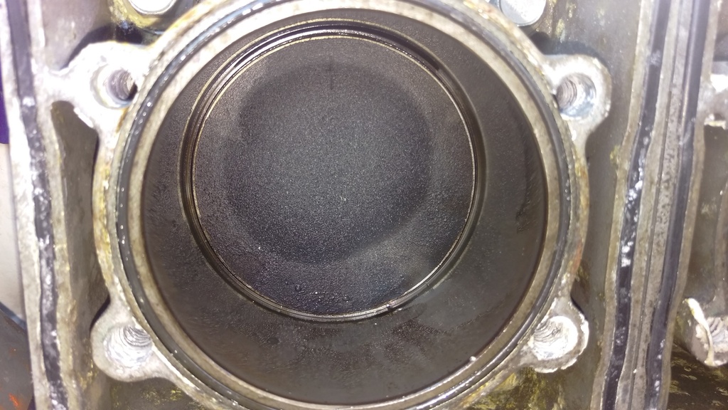

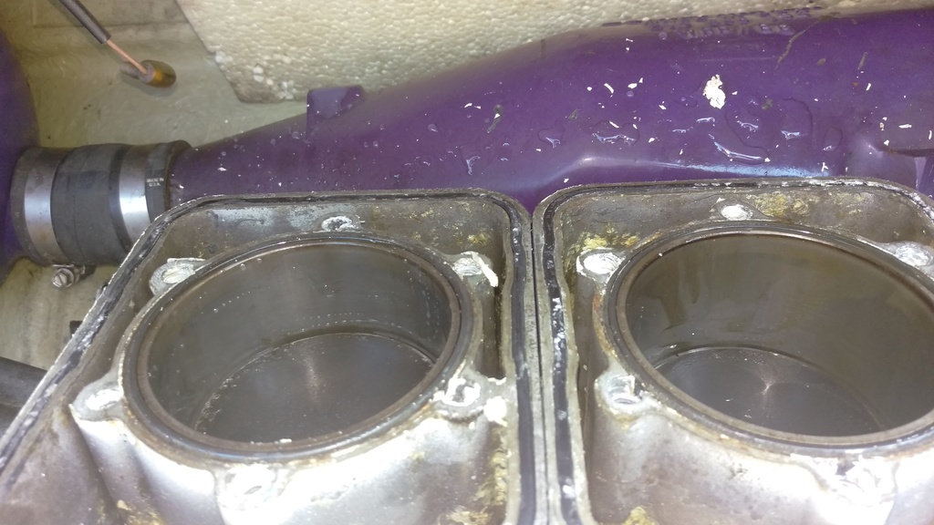

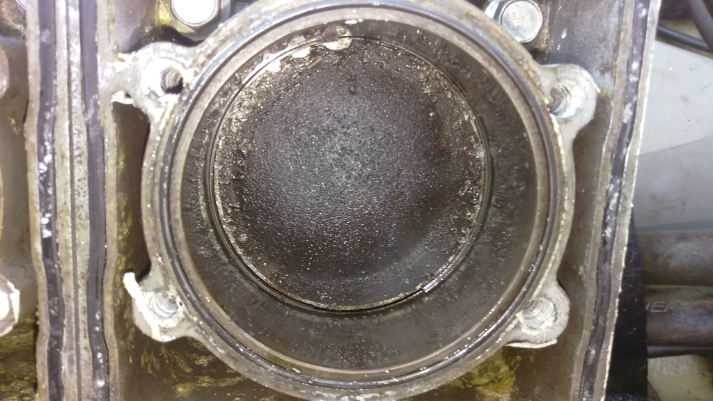

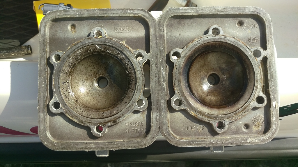

Plugs were black, crusty and fouled so i picked up a new set today but before i put them in decided to check the compression, 125 Mag 50 PTO. Started pulling things apart.
All pics are Mag right and PTO left.
Mag
PTO

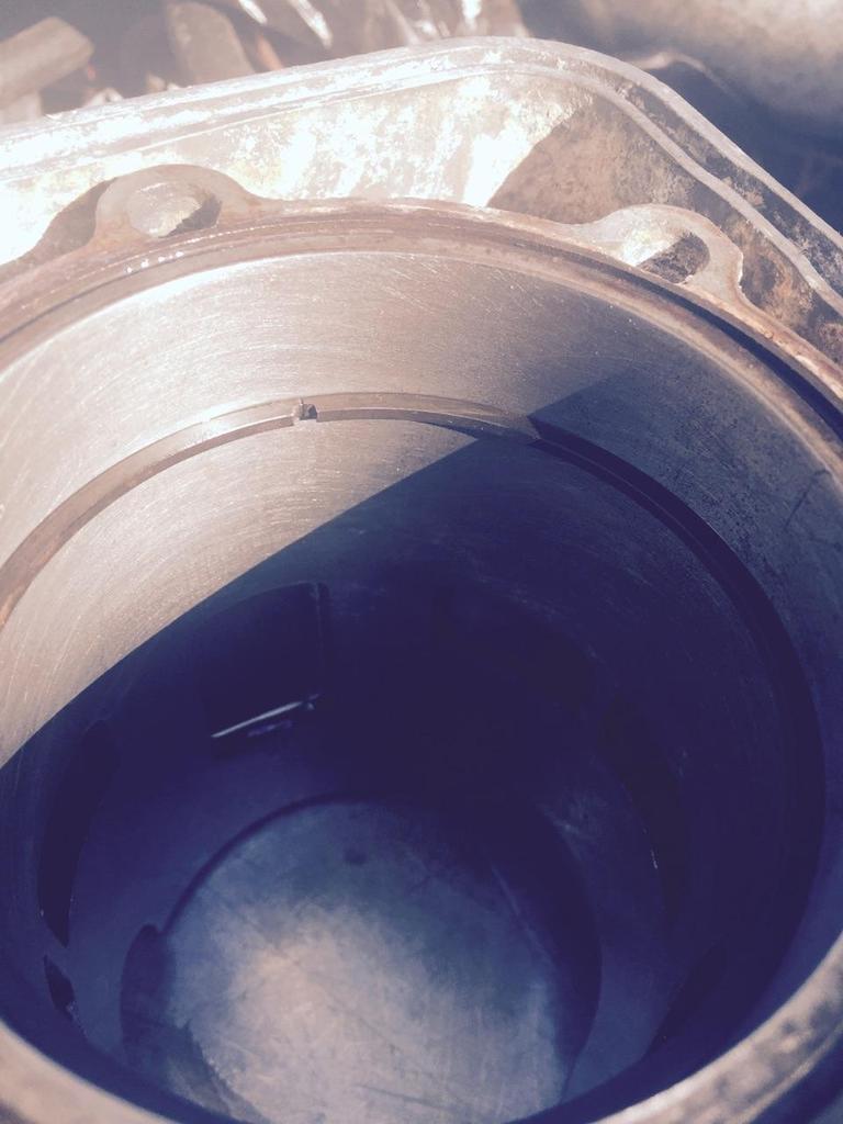

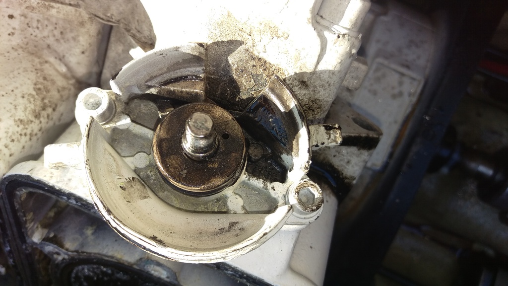

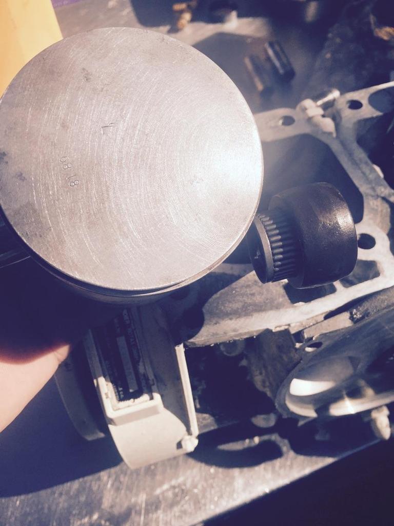

Looks like something was beating this up.
PTO Rave was leaking some oil but doesn't look like it was hitting.
I had cleaned them, new bellows, springs and o rings last year.
I have never done one but looks like a top end kit is in order.
So now the questions:
What caused this?

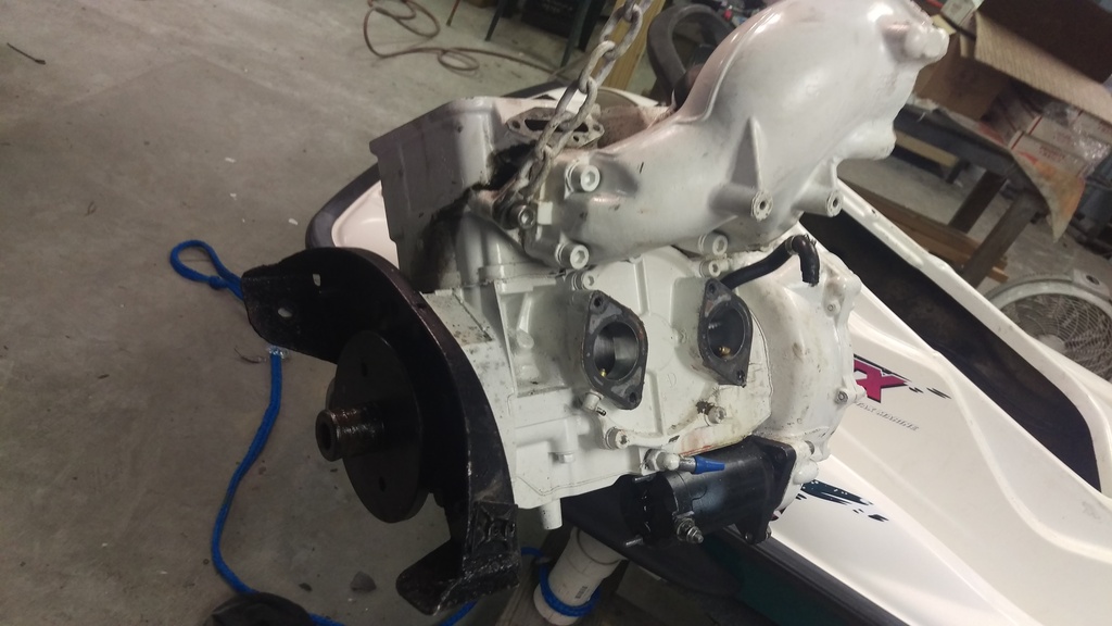

Can i do the top end kit in the ski or should i pull the motor?
I was supposed to take the skis to Destin Friday for the weekend, is this something i can complete by then if i get the parts Wednesday?
Where should i get the kit from?
Thanks,
