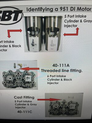

Is there anything different other than the injectors, water outlet, and the amount of ports in the piston sleeves? Anything in the computer or electrical?
I know there is a GTI LE version. I was looking at picking up a 2003 in that style. I thought I read it stood for luxury edition:cool:
Ive seen that the LE means low emission. On seadoo warehouse there is a normal rx di and a rx di (LE) also on sbt if you bought a rebuilt engine there are 2 options. image.jpg
