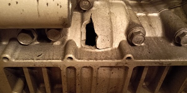

Can 951 carb engine cases be mismatched? One of mine has a large hole in the bottom case and isn't repairable. Can I get a used lower case with my good top case? I think SD says no. Thoughts?
The answer is no because they are machined and line bored to be a perfect matching set.
I am sure it has been done but it’s not correct and used matching cases aren’t that expensive.
You shouldn't, you really need to get a matching set of cases.
