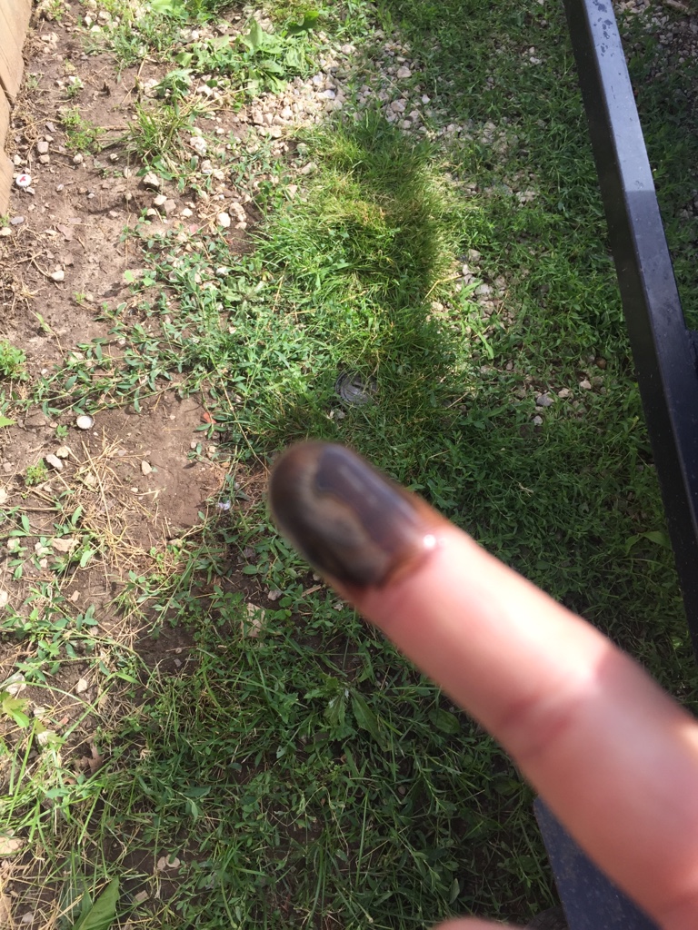

I'm confident the carbs and whole fuel system is clean and correct. So I pulled the easiest cover and this is what I found. What smells and looks fuel/oil solution. Looks to me like I may have found this issue??? Anyone ever see a mag crank seal cause this bogging
